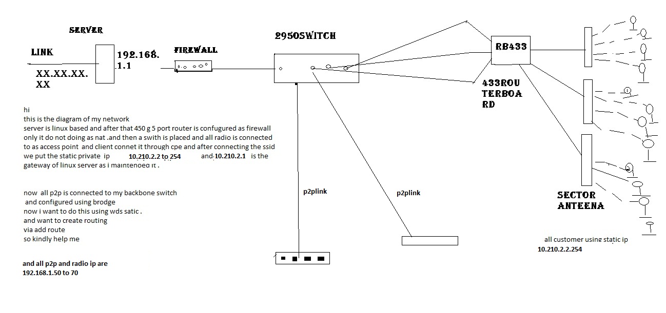

hello rodolfo
this is our network setup
link-server(linux)-450g(firewall only)-switch-and all radio and p2p connected to that switch.
server ip is xxx.xx.xxx.xx and the internal ip is 10.xxx.x.1,and all client ip start from 10.xxx.x.2 to 254.
all radio is configured as access point and client connect to the access point through static internal ip (10.xxx.x.2)
and all radio ip is 192.xxx.1.50 to 70 range.
and all p2p configured in bridge mode with dynamic wds.
now i want to configure all p2p link in routing mode so kindly help me in right direction.
how to configure the new p2p via static routing or through routing protocol.
plz help

hello rodolfo
here is my network diagram
kindly
tell me the step by step proces how to configure the static routing.
and how to enable nstreme on the router.you can send me code to how enable between routers
and how to enable ospf link between two router??? :frowning:
and also want to maintain one thing does ntreme require two wireless card on one router ??/

kidly have a look over that i am submitting the jpeg image of my network diagram
