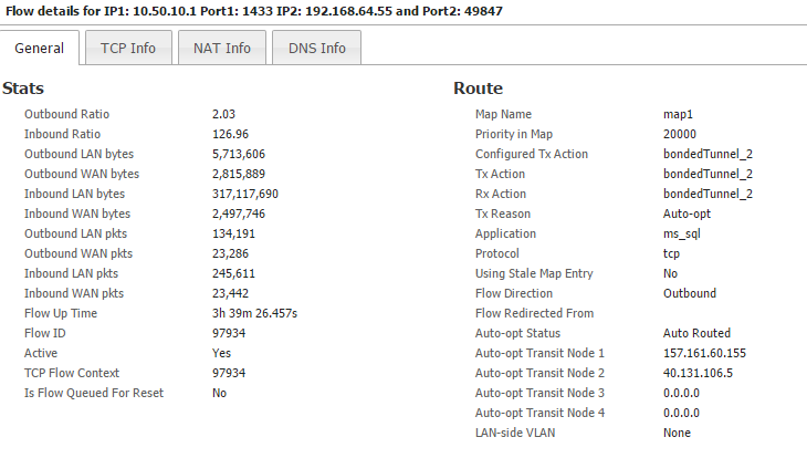

Here’s a screenshot of one of our very typical SQL flows I made yesterday. (192.168.64.0/24 is our local network in Switzerland, 10.0.0.0/8 is at the US east coast where the SQL server lives)
The most interesting part obviously is the LAN- and WAN-packet count - as you correctly stated, this dramatically cuts down latency as all the LAN ACKs are handled locally. And this HAS an impact on latency :slight_smile:
The Screenshot is from a virtual SilverPeak appliance but other vendors (we also use riverbed for other locations) are comparable.
