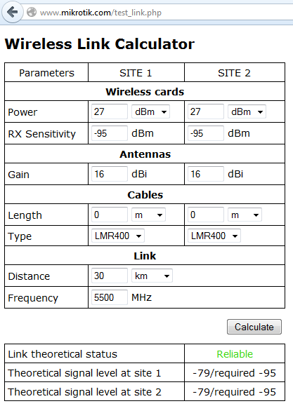

Specs of SXT Lite5 > http://i.mt.lv/routerboard/files/SXT-Lite5.pdf
Calculator > http://www.mikrotik.com/test_link.php
Result :
It is not possible to have a stable link.
The signal is too little so there will be something to weather influence the link will fall away.
Bad idee

(notice that the calculation is done with tx-power and rx-sensitivity for the lowest modulation of MCS0).
The antenna gain (16dBi) is just too small for 30km link.
For something truly usable and stable with reasonable throughput at that kind of distance
one would need a pair of 28dBi antennas.
