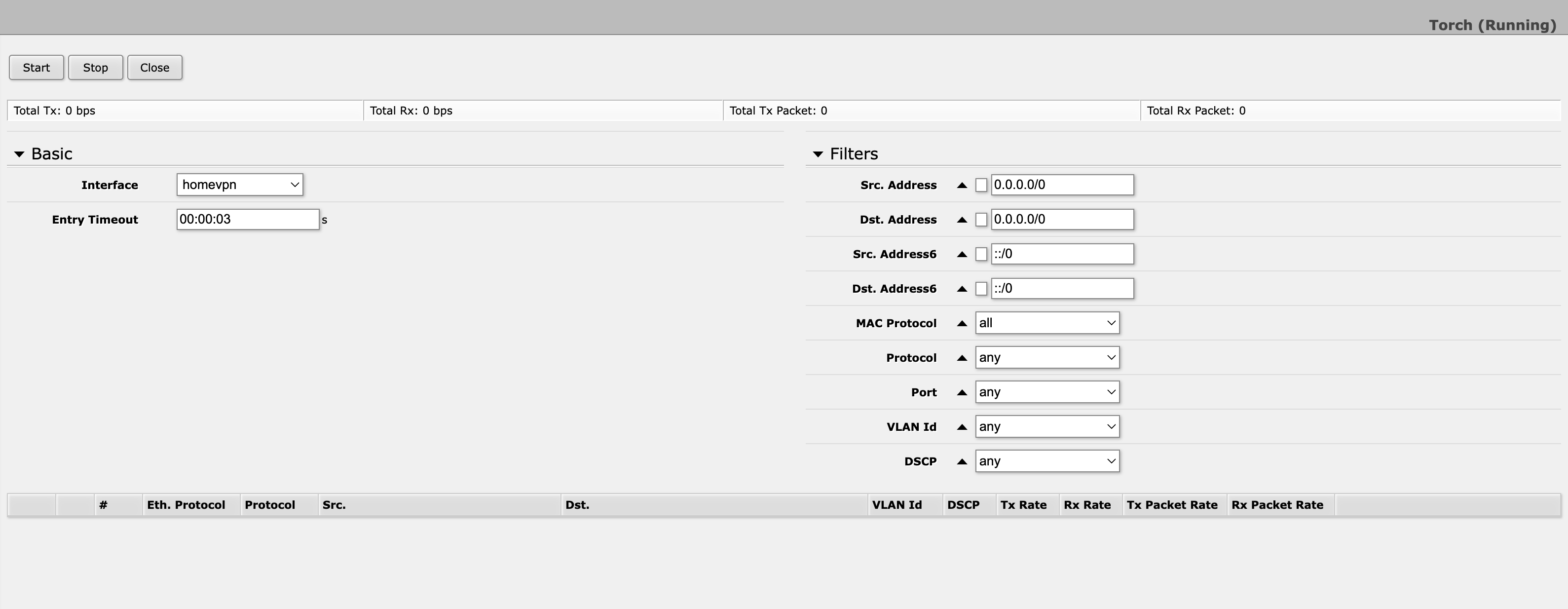

I’m troubleshooting a WireGuard connectivity problem, and I’m running into a problem when trying to confirm traffic is passing when using Torch. The handshake completes, so I know the VPN client is connected, and I see traffic on the graph for the WireGuard interface under Interfaces > homevpn > Traffic. However, when I try to view this traffic using Torch, I get absolutely nothing. For reference, this is my Torch configuration:
Torch is running on the hEX S that is also managing WireGuard connections.
