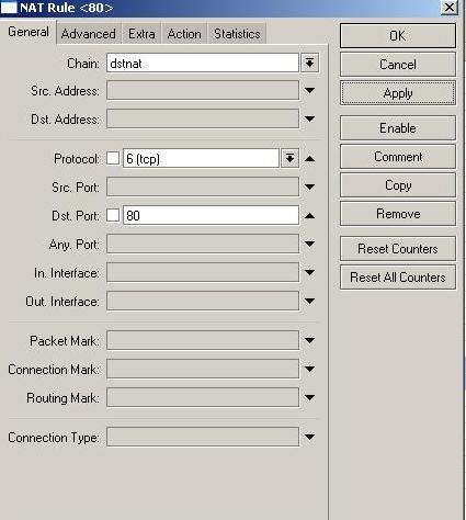

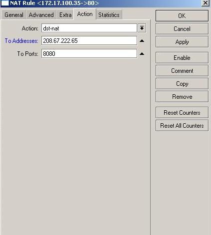

If i specify manually on browsers settings of clients, i can browse the sites without any problem. But doing manually on each and everyclient is cumbersome,
so in mikrotik ROS i made a dstnat rule as follow
chain=dstnat action=dst-nat to-addresses=ip.of.the.proxy to-ports=8080
protocol=tcp dst-port=80
but i get the following error.

this is the dstnat rule in mikrotik router
