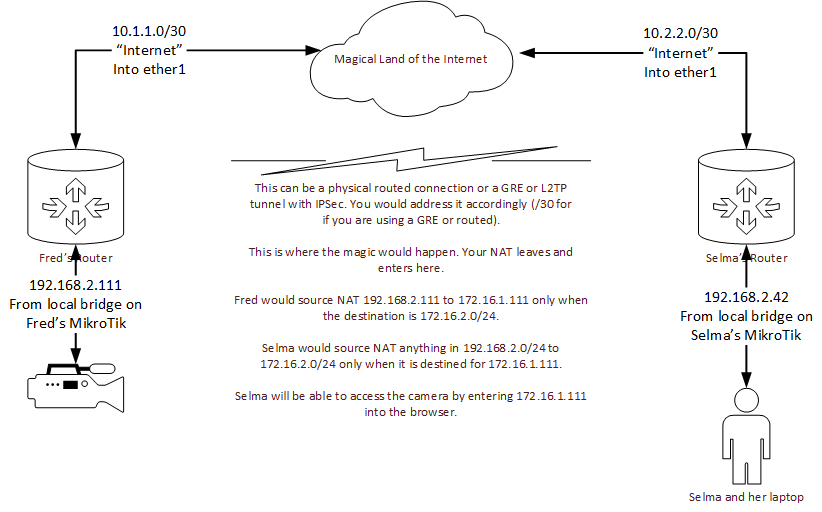

A common solution when faced with overlapping address space is to use a technique called double NAT. The way it works is we setup on your side a NAT statement that translates either the cameras 192.168.2.0/24 IP or the entire 192.168.2.0/24 subnet to an entirely different IP or subnet not used by either of you and we do the same thing on his side, he translates his 192.168.2.0/24 to another network. The key component is we only do these translations when packets are sourced from the overlapped space and destined for the others “fake” subnet.
Here is a drawing. It’s a fairly complex setup but it is the answer for how to deal with overlapping subnets. It’s also something I’ve pushed to start using in business to business site to site VPNs as well as it frees either business of having to care about what is on the opposite side of the VPN from an address scheme standpoint.
