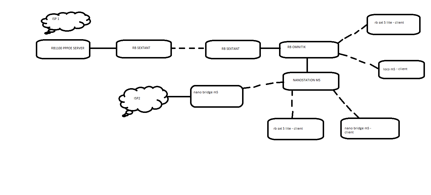

ISP1–port1–RB1100[pppoe server]–port6–Sextant < – > Sextant-------Omnitik----Nano Station M5 < – > NanoM5 Bridge----ISP2

maybe if you post a drawing of the network topology i can understand better.
RB 1100:
eth 1: WAN from ISP1
eth 6: to RB SEXTANT
so only 2 ports involved with one pppoe bridge so they can connect PPPoE. Let me know if you need anything else.
now i understand
i think vlan can do what you want
