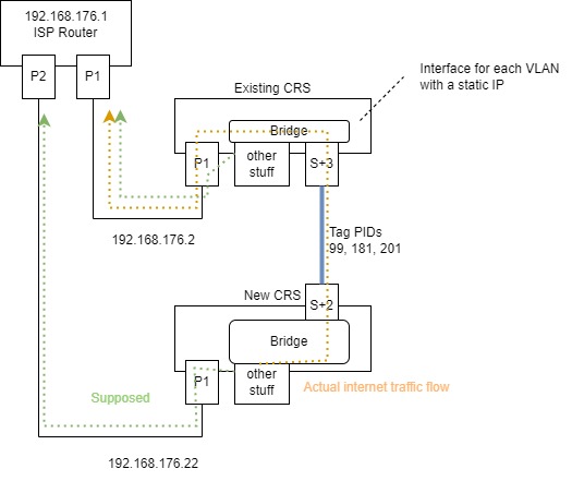

ISP connection for each CRS, but traffic is always sent through 1st CRS
I’ve run out of network ports on my current CRS328 and decided to expand by adding a CRS354. I am using one SFP+ port for a trunk to carry my VLANs to the new device. Works fine! Each client gets on the correct network and has access to what it should have. Very happy about that so far.
My plan is to avoiding all my WAN traffic passing through the trunk port by adding a link from the CRS354 directly to my ISPs router on its 2nd port. While the first port is used by my existing CRS. Is this actually doable? I seem to be failing after spending half my day and night on this.Obviously something is missing with the implementation or my thoughs. I can’t seem to figure it out by myself and would like to ask for assistance please.

I added an illustration to hopefully better convey the topic. Thank you for your thoughts and ideas.
Why is e1 member of the bridge?
Looks like a Layer-2-Loop / Spanning-Tree problem to me.
Thanks for the hint. Yesterday evening I was able to continue investigating and the actual resolution turned out to be a wrong gateway.
As long as the gateway was set to my old device, traffic would of course go through there. I changed the gateway to the new device and everything worked as intended. Now I just need to spend some time on the weekend to distribute the gateways according to the clients plugged into each CRS.
