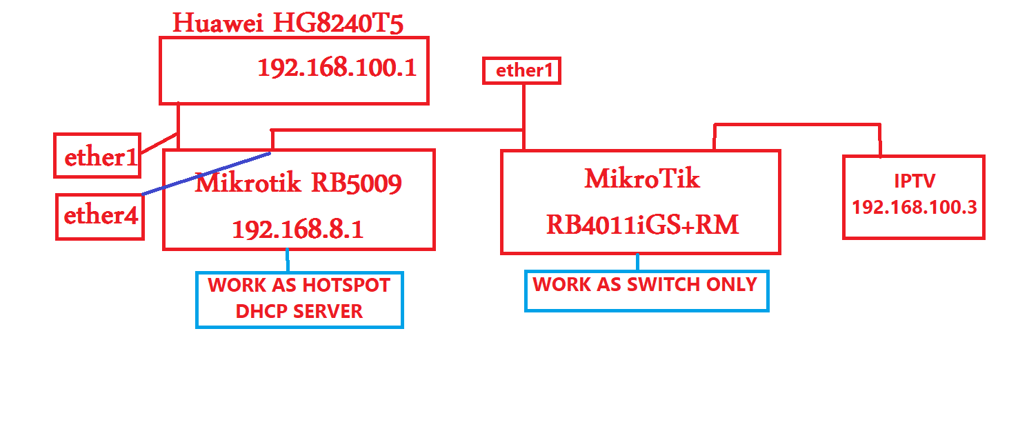

My service provider install Huawei HG8240T5 GPON unite with DHCP enable and I don’t have any access to it and I can’t change any thing on it and the IP is 192.168.100.1
the service comes with VOIP and IPTV and all device has static IP and all device are locked I can’t do any change
NOW I have Mikrotik RB5009UPr+S+ how I can configure MK with same IP range of GPON !!! I ask one of my friend and he relayed to set MK as a switch and other friend said set MK as DHCP server with hotspot
I need you opinion from your experience what is the best way to configure MK

thanks erxtended for your reply
I tried to what you mention but I realised that I have to all clients IP address on my network any iv'e heard about VLAN that if I configure vlan on mikrotik the iptv will work
do you have any help on that please
with regards
note:
iptv connect to RB4011iGS+RM on ether9
