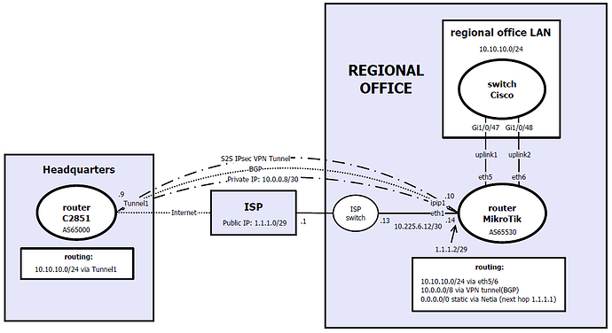

We have following scenario implemented at one of our regional offices:
MikroTik router connected to ISP switch via private IP and to ISP router via public IP (both over one link connected to switch).
There is also S2S IPsec VPN Tunnel from MikroTik router to the headquarters - another private IP connection and BGP running througt this tunnel.
network diagram:
To get this setup working on MikroTik, we had to configure static ARP at MikroTik router for the public IP of ISP router:
/ip arp
add address=1.1.1.1 interface=ether1-gateway mac-address=00:AA:BB:CC:DD:EE
This is actually the MAC address of ISP switch interface (10.225.6.13/30).
