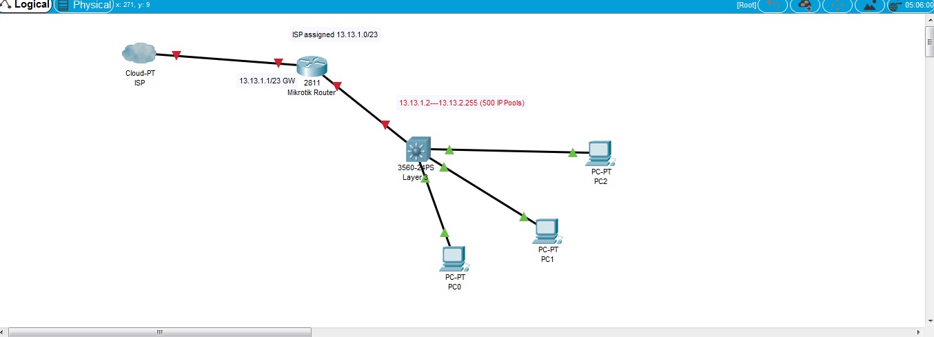

I’m not new in Router OS, but from long time I’m working on NATTing, Now I have some issue regarding ROUTING public ip addressing to the clients.
My network Diagram also attached with this topic, My ISP has assigned me 13.13.1.0/23 public IP pool (here pool assigned IPs are fake provided deliberately) .
Pool: 13.13.1.0/23
My Mikrotik Router GW: 13.13.1.1/23
My Mikrotik WAN Interface IP: 13.13.1.2/23
IPs Pool available: 13.13.1.3----13.13.2.254/23
I dont want to use Proxy-ARP, as I’m already doing all this by PROXY-ARP… My ISP doesn’t provide me anything like RIP,OSPF…they had provided me Static Routes only…
How should I run this scheme to my users.. I’m running pppoe Server by assigning using public IP Pool from my DHCP.
Please do help…

The right way would be to get whole /23 routed to you. You don’t need RIP, OSPF or anything, static route is fine. But as you described it, it looks like it’s not routed, but used on the link between you and ISP. Which would not be ideal, because you would have to use proxy ARP to route invidual addresses further behind your router. Are you sure it’s like this from ISP, or can it perhaps be your misinterpretation of what they gave you?

Yes, I’m sure becoz, I’m using this PROXY-ARP from last 2 years and now I need to change this for Routing…
Tell what should I do, or any alternative possibility??
can I use OSPF without ISP provision??
example,
#example 1
#R1 example configuration,
/ip address add interface=wan_interface address=13.13.1.2/23 disabled=no comment="WAN IP"
/ip address add interface=lan_interface address=13.13.1.3/23 disabled=no comment="to_switch"
/ip route gateway=13.13.1.1 dst-address=0.0.0.0/0 disabled=no
/ip route add dst-address=13.13.1.4/32 gateway=13.13.13.1.3 comment="PC 1"
/ip route add dst-address=13.13.1.5/32 gateway=13.13.13.1.3 comment="PC 2"
/ip route add dst-address=13.13.1.6/32 gateway=13.13.13.1.3 comment="PC 3"
#PC 1
ip address = 13.13.1.4
netmask = 255.255.254.0
gateway = 13.13.1.3
#PC 1
ip address = 13.13.1.5
gateway = 13.13.1.3
#PC 1
ip address = 13.13.1.6
gateway = 13.13.1.3
It’s not really up to you. There are two basic possible configs that ISP can use. First is routed subnet, where config from ISP’s router would look like this:
add interface=<to_customer> address=14.14.14.1/30
add dst-address=13.13.1.0/23 gateway=14.14.14.2
There would be one connecting subnet, in this example 14.14.14.0/30 and you’d have 14.14.14.2 on WAN and use 14.14.14.1 as default gateway. And whole 13.13.1.0/23 would be yours. But what you describe looks like not routed subnet, where ISP’s router has:
add interface=<to_customer> address=13.13.1.1/23
If that’s the case, ISP expects all addresses from /23 to be directly reachable on same link. And if you need them routed further, you have to use proxy ARP. I’m no OSPF expert, you can probably use it in your network with these addresses, but you still need to have proxy ARP on WAN, otherwise ISP wouldn’t be able to communicate with them.
Hello MRTCA
your posts commands and structure not works, Please suggest anything oR any butter workaround
Dear SOB
My thoughts are similar what you had told me, but my ISP not providing me more IP Space…Well hope will get any other possible options.
You don’t need more IP space, just a different way to deliver that /23 to you. But if ISP refuses to do that, you can pretend that you have whole /23 for yourself and only use point to point for WAN:
add address=13.13.1.2/32 network=13.13.13.1 interface=<WAN>
add dst-address=0.0.0.0/0 gateway=13.13.13.1
You’ll still need proxy ARP for WAN interface, but I don’t see a problem with it. Since WAN will have only point to point IP config, you can do whatever you want with whole /23, except for .1 and .2 used on WAN, and it should be ok.

Same subnet on two different interfaces generally doesn’t work very well…
