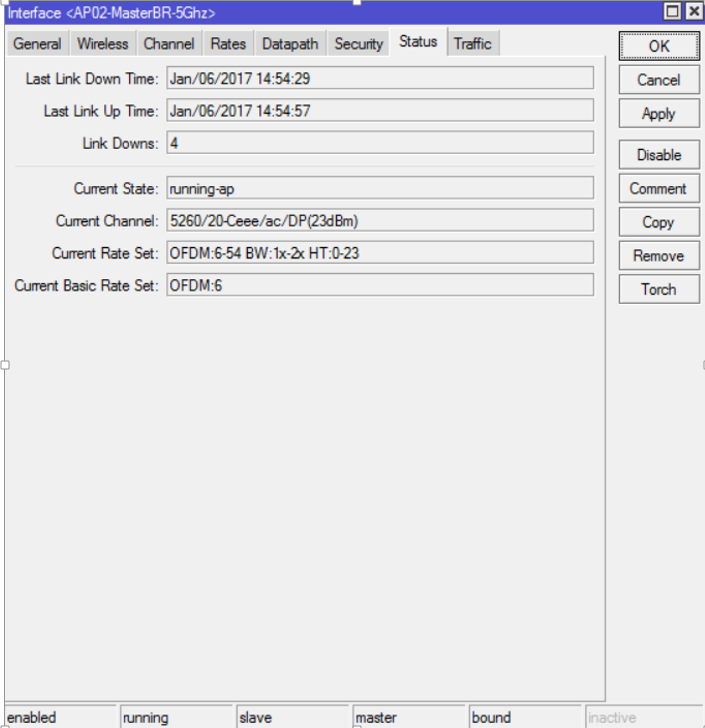

Here’s the effect of that configuration on the interface details, please note the “current rate set” section:
 1 M BR name="AP02-MasterBR-5Ghz" mac-address=E4:8D:8C:D5:41:6C arp-timeout=auto radio-mac=E4:8D:8C:D5:41:6C master-interface=none
        configuration.mode=ap configuration.ssid="Jorbu" configuration.max-sta-count=30 configuration.multicast-helper=default
        configuration.tx-chains=0,1,2 configuration.rx-chains=0,1,2 configuration.guard-interval=any
        configuration.country=united states configuration.distance=indoors configuration.hw-retries=0
        configuration.hw-protection-mode=none security.authentication-types=wpa2-psk security.encryption=aes-ccm
        security.group-encryption=aes-ccm security.passphrase="password" datapath=JorbuDatapath l2mtu=1600
        datapath.client-to-client-forwarding=yes datapath.bridge=bridge1 channel.width=20 channel.band=5ghz-a/n/ac
        channel.extension-channel=Ceee rates.vht-basic-mcs="" rates.vht-supported-mcs="" current-state="running-ap"
        current-channel="5260/20-Ceee/ac/DP(23dBm)" current-rate-set="OFDM:6-54 BW:1x-2x HT:0-23" current-basic-rate-set="OFDM:6"

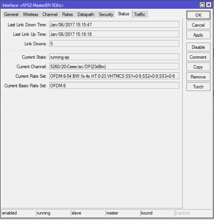

Here’s the interface details, note the “current-rate-set” property (6.37 seems to print out a lot less detail than the newer version):
 1 M BR name="AP02-MasterBR-5Ghz" mtu=1500 l2mtu=1600 mac-address=E4:8D:8C:D5:41:6C arp=enabled arp-timeout=auto
        radio-mac=E4:8D:8C:D5:41:6C master-interface=none configuration=Configuration_Jorbu5Ghz current-state="running-ap"
        current-channel="5260/20-Ceee/ac/DP(23dBm)" current-rate-set="OFDM:6-54 BW:1x-4x HT:0-23 VHTMCS:SS1=0-9,SS2=0-9,SS3=0-9"
Please note, I was also able to reproduce this issue in v6.38; and have not found a way to allow the 5Ghz radios to reach the higher MCS in either 6.38 or 6.39rc7.

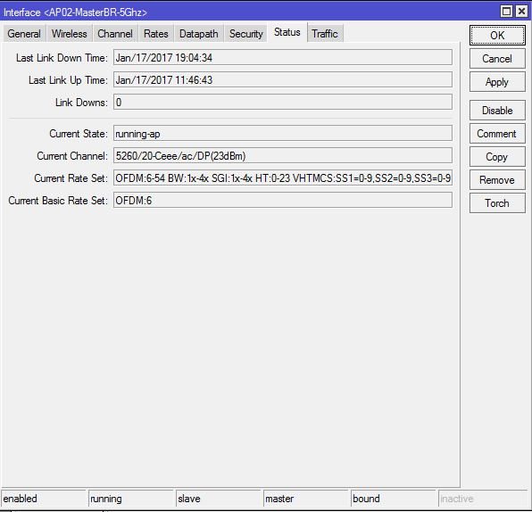

This is a known issue and should be fixed in 6.39rc12
Updated to RC13, all appears to be working fine. Radios now advertise SGI too:
