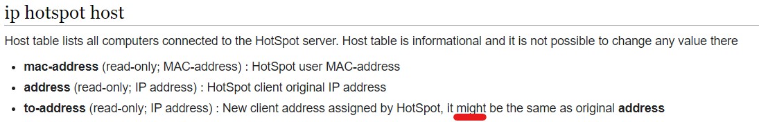

When i looked at host menu i saw different IP address for Nanostations as illustrated in attachment pic,so what’s wrong with that?

Is that the hotspot hosts table?
This is information about the clients. The hotspot (re-)assigns the IP address.
The Hotspot indeed makes an IP translation ( if the to-address parameter is used ), but that won’t actually change the IP of the Device itself ( i think that is obvious )..
If for example 2 Laptops are connected to the Hotspot and they have static IPs assigned to their interfaces, if the parameter to-address under the user’s Profile is used, those IPs will be translated ( according to the IP Pool used ) in the Hotspots Host Table but that does not mean that those 2 Laptops can not communicate with each other using the Static IPs assigned to their Interfaces…
So if the AP has a static IP assigned to its interface, then a device in the same subnet should be able to reach it regardless of the Hotspots IP translation …
They will communicate just as the other clients communicate among each other, if the traffic is not passing through and triggering the NAT of the hotspot.
