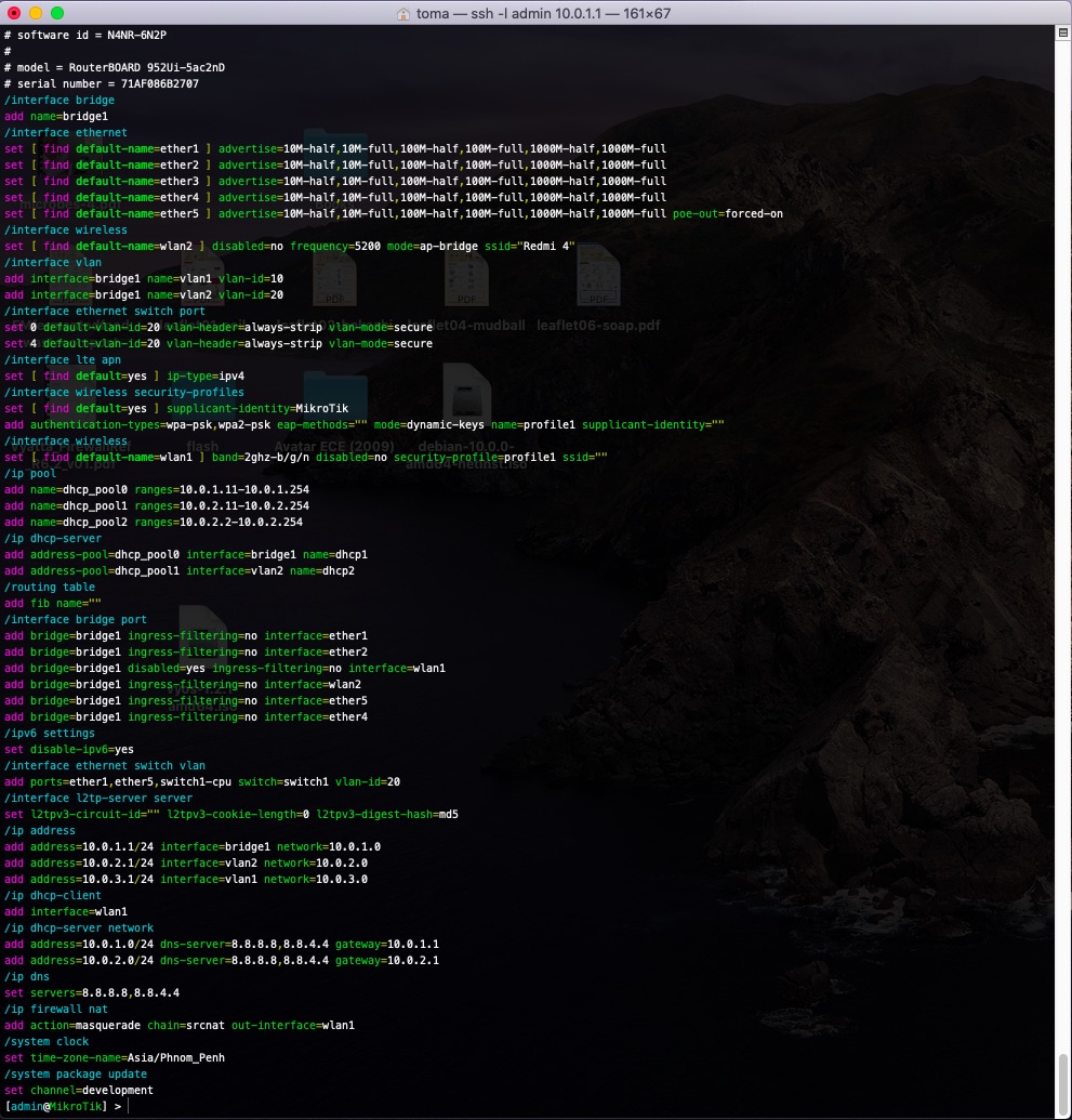

I have issue with vlan on switch chip, I configure multiple DHCP server on multiple plan so far it work both macOS and window10 but since I updated to v6.48 or v7.1rc1 it work only on window. RouterOS offered ip but macOS cannot received ip
any idea?
