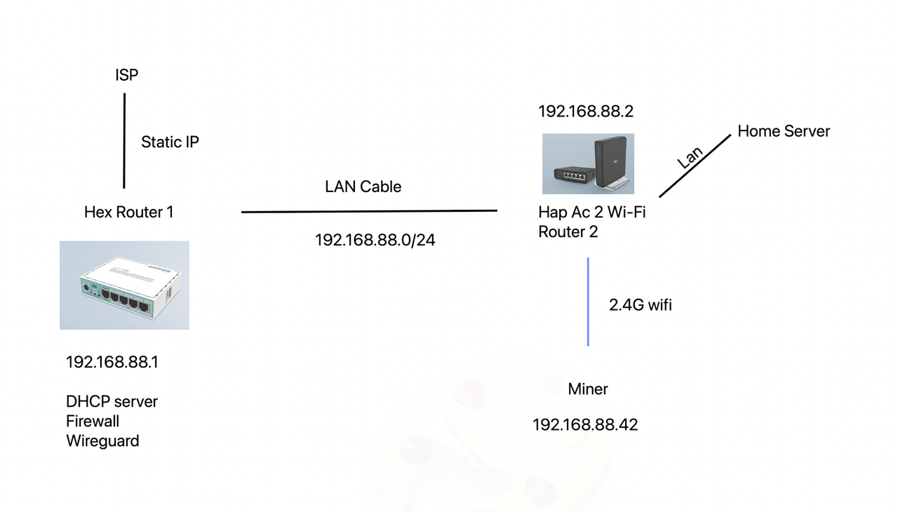

Hi all, so as it states in the topic header I have issue opening a port to my miner. My setup is very simple.
I have a MT router Hex RB750r3 (Router#1) which is the main router that serves the internet from the ISP. The ISP lan cable is connected to ether1, the DHCP server is on that router, firewall is here as well.
I have another MT hap ac2 (Router#2) that serves the wi-fi at home.Ether1 is connected to router#1 via lan cable.
Miner is connected via 2.4G wifi, for now I do not have cable access. The problem is I need to open port 44158. I tried doing it on the main router from the mobile app, it used to worked before but for devices connected via a lan cable to the same Router#2. But now it does not work. I have a static IP address, I have control over my network, just don’t have enough knowledge to make it work as I wish. I just want to turn my Hap Ac 2 into a simple switch, that only connects devices and forwards everything to the main router. Any help would be greatly appreciated. Thanks in advance.
Please see below the configurations of Both routers.

    in-interface-list=WAN protocol=tcp to-addresses=192.168.88.42 to-ports=\
    44158
add disabled=no dst-address=0.0.0.0/0 gateway=192.168.88.1

Simple Diagram
