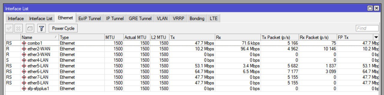

It happens that I have a network with static ips /24, on a bridge.
This bridge has 6 ports assigned, among those:
Combo1, ether4, 5, 6, 7, 8.
The network works apparently fine, however when I go to /interface ethernet, the transmission traffic on combo1, ether7 and ether8 are the same, exactly the same.
If I torch the ether7 or ether8 I can see all the traffic that is generated on the /24 network, even though only two tplink routers are connected to those two ports, with one ip each.
What do you think this behavior is due to?
