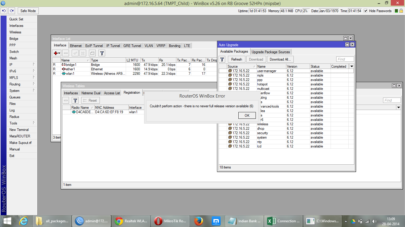

I tried for the last two days, i couldnt drag the files to the winbox, the winbox window for this router doesnt allow dropping the files, but today i tried to check in auto upgrade option from a remote router, it showed the latest version but when i clicked download all option it showed no newer version found for this router, and again i selected individual package clicked the download option and it got download to the file list, and so i did the same for all the packages, and now updated to the latest 6.12 version. i have no idea what went wrong whether my router or the 5.26version, anyways now it solved, thanks for trying to help dude[npero]
