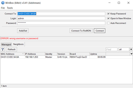

I try to configure a MIKROTIC SXTsq 5 ac bridge using WinBox soft but I encounter a problem :
I cannot connect the device using the MAC address (in Neighbors). Picture 1

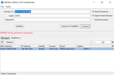

I Also tried with the password on the sticker but the result is the same. Picture 2
Do you have an explication of this issue and how to resolve it ?
Thank you
What about the given feedback: “ERROR: wrong username or password”
You might need to do a hardware reset to default config, to get the username and password of the sticker installed.

Might have to reset as bpwl said:
Wrong credentials here means that you can connect to a device which rejects the given credentials. Otherwise it’d give you another error message. The SXTsq5 seems to be some small hotspot https://mikrotik.com/product/sxtsq_5_high_power
Since it is discontinued, it is old. Since it’s old, someone likely was using it with another set of credentials.
carrotik
I did a hardware reset to default config. Doing that, I was finally able to connect the device using the password of the sticker.
