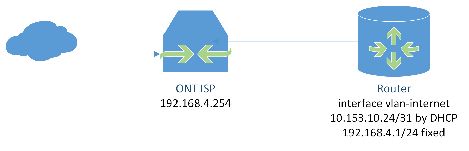

On one interface, I have a DHCP address given by the ISP and a fixed IP to access the adminstration of the box (ONT).

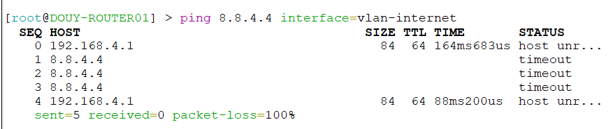

and when I ping from my interface, in some case, I obtain this result.
Can anyone think of a way to do this?
Most probably it’s your SRC-NAT settings. Default config has construct something like this:
add chain=srcnat action=masquerade out-interface-list=WAN
Which works fine if WAN interface has only one IP address set. In your case (with two IP addresses) you have to create different SRC-NAT rule:
add chain=srcnat action=src-nat to-addresses=<IP given by ONT> out-interface=vlan-internet
There’s gotcha: as IP address is given by DHCP, it can change. This problem can only be overcome if actual intetnet is passed via different interface than management. Your diagram mentiobs vlan-internet … does management work via same tagged VLAN or via something else? Does ONT have multiple “LAN” interfaces (in this case you could connect two ports, on router use them individualky one with DHCP client for internet and the other with static IP address for management). There are many possibilities, which one is feasible depends on details.
Edit: yet another possibility: routes are set in a way that allows default route via management IP address. So we do need more details, preferably post textual export of router’s config … complete one.

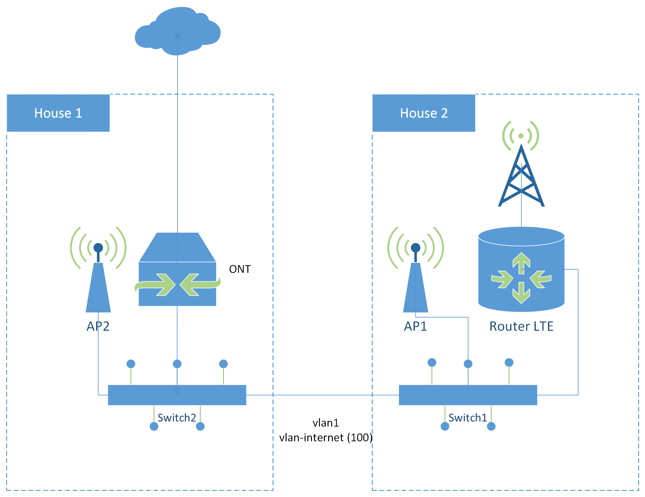

Thanks for your answer but unfortunately, it doesn’t work.
In fact my problem only appears when the priority of the default route (vlan-internet) changes. I put this mechanism to have 4G fail-over. If I can’t ping the IP 8.8.4.4 through the vlan-internet interface, I increase the priority of the vlan-internet route to be higher than that of my 4G connection.
Everything works perfectly if I remove the 192.168.4.1 address on the vlan-internet interface. No possibility to use 2 ports and I want to access the ONT box to retrieve the metrics.
Below is my configuration. Thanks for any help.

Below is the diagram of my implementation.
My problem is that I only have one cable between the two buildings and the router and the fiber are not in the same.
The ONT does not directly give an internet address but in 10.xxx.xxx.xxx.
OK. So what’s VLAN status of port on Switch2 connecting to ONT? I guess its untagged.
As I wrote before: when “main” IP address is dynamic, it’s hard to make src-nat “sticky”. So I’m really hoping that disabling detect-internet does the trick. If it doesn’t, please check (in depth) running values of /ip address and [/i]/ip route[/i] (use print detail command which shows running values, not the configured ones) to check actual state of router when it’s not working according to requirements.
Well, here I am. I turned “dectect internet off” but it didn’t change anything.
Here is a more detailed diagram to understand what I did.
It works except for the problem I exposed. It’s true, I’m not sure I did this correctly. Thanks in advance for your insight.
I don’t know why exactly you’re seeing default route to misbehave the way you explained. I still think you should do the route troubleshooting I mentioned previously.
And I still think that the way you’re using ether1 (half way between stand-alone interface and bridge port) is wrong and could cause problems you’re seeing. I suggest you to redesign router to work with single VLAN-enabled bridge. And my personal belief is that when starting to go with VLANs, all network infrstructure should be VLAN-only (meaning all switch-switch traffic, switch-AP and router-switch traffic should be tagged), only ports connecting end devices should be untagged (access) ports. It makes things simpler to configure because no “VLAN” needs special treatment.
While reading your previous posts another question popped in my mind: the default route, is it set by DHCP client?
It seems odd to see it using interface as gateway, I’ve always seen it set upstream router’s IP address as gateway. I can imagine that when gateway is set to interface and interface has multiple IP addresses set, auto-selection may select wrong source address because there’s no other hint to help it make better guess. If gateway is set to IP address, then router will know to select source IP address matching destination best.
[edit] I see that dhcp-client has “add-default-route=no” … I guess it expkains why default route seems odd. Try letting DHCP client to set default route and only fiddle with priority values for the LTE fall-back.
