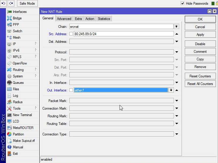

I have new RB951G-2HnD router. I did basic configuration of subject device with static ip address.
Here is my configuration:
add address=80.245.89.17/24 interface=ether1 network=80.245.89.0
add distance=1 gateway=80.245.89.1
add action=masquerade chain=srcnat out-interface=ether1
Issue is that I can’t ping my gateway and any other ip addresses outside the lan.
Why it’s not working?

efaden
January 16, 2014, 6:50pm
16
add action=masquerade chain=srcnat out-interface=ether1 src-address=
80.245.89.0/24Thats not right…
Get rid of the source address. Should be
add action=masquerade chain=srcnat out-interface=ether1Also… try ping 8.8.8.8 from the console on the mikrotik and see if it works.
gering7
January 16, 2014, 6:56pm
17
efaden:
previously I had correct value, somebody told me try this value and I forgot revert it. Now did that and result is the same. Timeout when I ping 8.8.8.8 address
