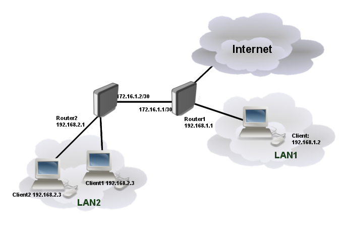

I have a mini ISP where I install the Mikrotik RB1100AHx2 Router. I have created the VLANS on one of its port. All the VLANS are terminated in CISCO 2950 Ceries Switch. One VLAN is issued to a remote site where RB750GL is installed.
At RB750GL I am receiving a public IP from RB1100AHx2 and then serving Internet on Private IP 172.16.10.0/24 . Now I need to give some of my clients Public IPs. There is no VLAN configured at RB750GL side. I am a little bit confused that how to bridge both routers with each other so that my Public IPs from RB1100AHx2 get delivered to clients on the remote site?
A rough idea about the network is as follows.
Mikrotik RB1100AHx2
Port 1 = 123.456.789.001/29
Port 2 = VLANs
VLAN2= 103.28.27.23/24
and the list goes on
now VLAN2 is connected with a wireless link and wireless PtP device is on 10.10.10.201/24 and on remote site it is 10.10.10.202/24
Can anybody help me how to forward them?
Kindly check the attached image
https://www.dropbox.com/sh/ah00kb3g3l6s5a4/AABjDZHjfcI4syGbtL7FIuEJa?dl=0#lh:null-diagram.png
I think no body is understanding what problem we are facing? For your convenience i just try to upload another picture. Hopes to listen back from you guys soon.
