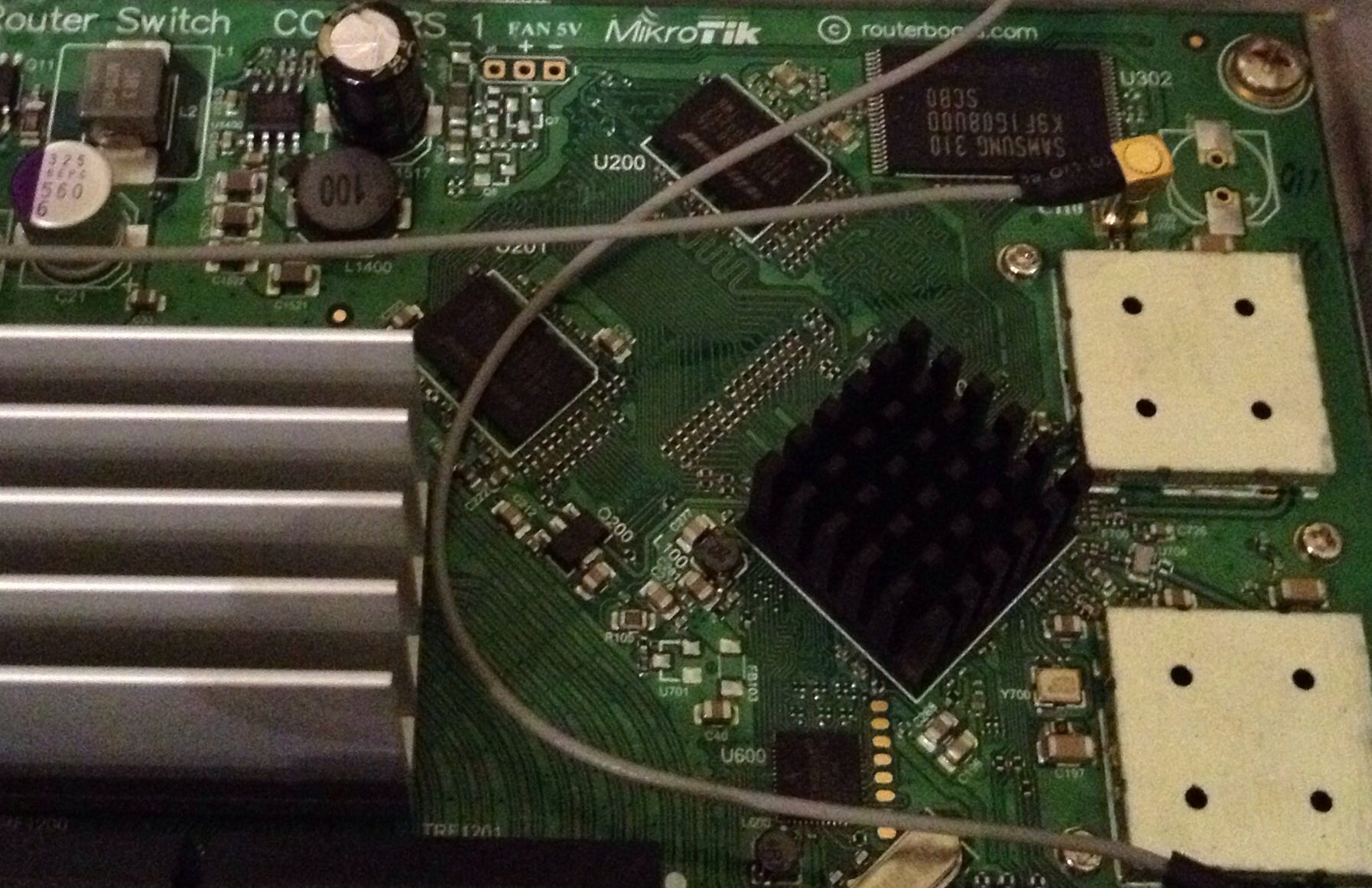

Mikrotik support found the problem source: the issue happens when the antenna cable (the cable that connects onboard wifi and the omni antenna) goes over the PCB. So, if you move the cable aside the PCB, the board works fine. Go figure…

I know that isn’t very comforting, but it realy works ok. We performed numerous tests and torchured the board and it behaved ok.
I can confirm the same problem and confirm that solution, mentioned by tnakir, works.

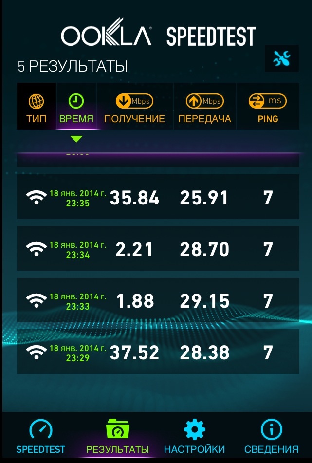

Disassembled the router, moved both antenna cables away from the board and (just in case) glued them to the case with glue gun, so they can’t go back and touch the microchips. After that wifi speedtests jumped from 1-2 Mbits/s to more than 30 Mbits/s and router passed two hour stability download test without problems.

After Hours of searching slow wifi , i found this thread, and i opened my MK router and put aside the cables , now i can get 24mb download , before i was maxing out at 5 to 10 mb depend how far i am ,
