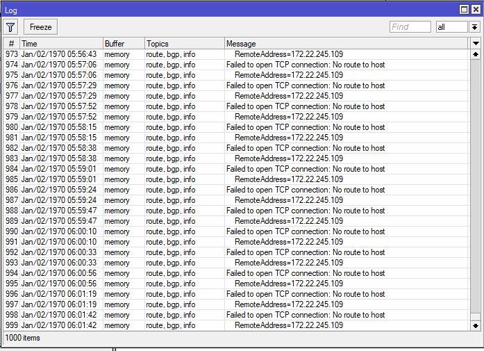

I have a problem with the bgp connection, I did a factory reset a mikrotik ccr1072 rotuer, but now I can’t get it to establish a bgp session, before the reset it worked fine.
I enter all the data provided by the operator, but the session is not established
the log gives me this error
I attach the error that appears in the log, help me please
You’re attempting to peer with 172.22.245.109, but you don’t have a route to that network. It’s either supposed to be connected directly (say you are support to be 172.22.245.110, and there’s a cable between the two routers), or you reach it via some other form of routing (statics, ospf, etc).
