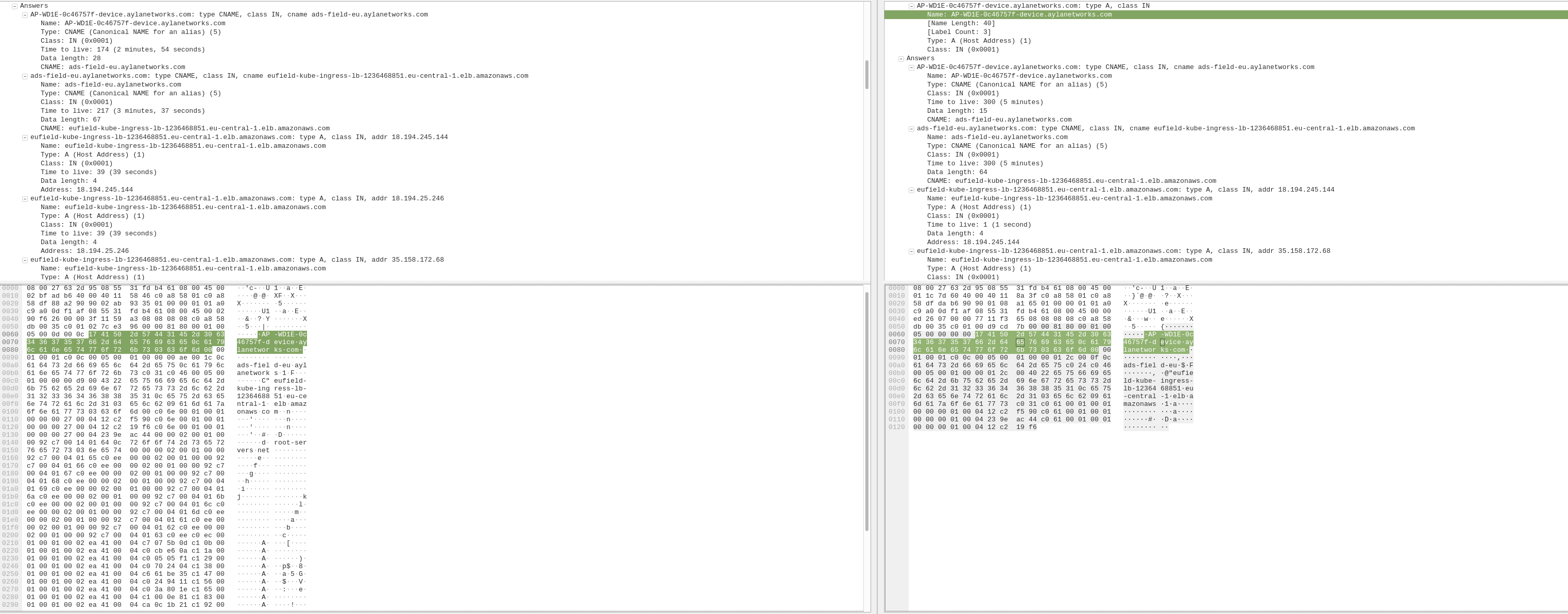

Resolved this in the meantime.
DNS is the problem, but the DNS packet itself.
Packet sniffing revealed that response packet is somehow changed when going over new ISP, I’ll attach a picture.
It is the same response packet, both originate from 8.8.8.8 one on the left is new ISP, one on the right is my old ISP. My MT configuration is identical, except for differences in ISP Internet connection, old one is just a dhcp client, new one is PPPoE on a vlan interface.
Aircon is probably hardcoded to receive packet on the right. Anything changes, and cloud control does not work. Even though DNS response in both cases points to correct address.
Solution is to transition to DoH, so that ISP cannot touch DNS packets.
This applies to Fujitsu General and Hisense aircons as far as I know.
