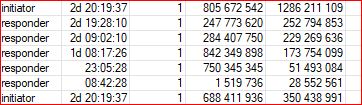

Hi, I am having an issue with IPSec/IKEv2 tunneling to Azure VPN. The tunnel connects and work fine but every now and again the tunnel disconnects and then the remote Mikrotik displays ‘Responder’ under IP/IPSec/Active Peers when it should read ‘Initiator’. I have to delete the entry to have the tunnel reconnect. Is there a setting I can use to make sure that the client router always sets itself as initiator? The Peer setting is set to ‘Send INITIAL_CONTACT’ and passive is disabled.

Hi, for whatever reason, once the link has dropped it doesn’t reconnect and when I look at Active Peers, my Mikrotik says says responder in the ‘Side’ column. If I delete that entry then the new entry that appear says ‘Initiator’ the then only does the tunnel reconnect. See image below. At the moment it is correct saying ‘Initiator’
So we’ve actually got several mysteries here - why the connection fails, why it re-establishes with swapped roles of the peers, as you say that the AWS peer acts as a responder only, and why the tunnel doesn’t work in this case.
As already said, only logging can shed some light on what actually happens.
