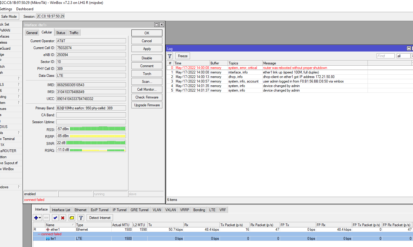

  1. Boot up router with card install, card seems to connect according to LTE interface “cellular” tab but router says interface is down and does not get an IP address from the modem
  2. Disable LTE interface and re-enable. Card shows up as connected and I can access internet.
Screenshot prior to disable/re-enable of LTE interface: not_connected_on_boot.png
Screenshot after disable/re-enable of LTE interface: connected_after_disable_enable.png
I upgraded the modem firmware and this did not help. I have tried putting the modem in ECM mode as well but the router does not stay connected in this mode. Do you have any ideas on how to make this work reliably? Or is there another modem supporting LTE bands 2,4,5,12,30 and 66 that has better support?

The AT&T plan I’m using is allowed in hotspot and non-hotspot type devices and I’ve tested the same SIM in some “hotspot” type devices such as Teltonika and Pepwave and it works normally. On this LHGR, simply disabling the LTE interface and enabling makes it work properly further indicating it is not a plan/imei type issue.
According to the cellular status information on the LTE interface, it seems the LTE card is working properly the whole time. I believe there is some issue between the card and the router where the router is not properly obtaining IP information on initial startup.
