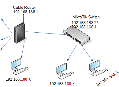

Thanks Anav for your response,
Here is the diagram. For now I cannot remove the cable router so this is how i have setup my network. Let me know if the changes you suggested will resolve the issue.
For now i would like to resolve my network issues first, I will work on the firewall setup next.

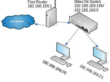

I redid my Mikrotik configuration. As per the suggestion I planned to setup router as bridge (i failed before but wanted to try it again) . But before i set it as bridge i wanted to ensure my Mikrotik configuration is good to handle LAN traffic. For some reason i continue to have issues, there is something i am doing wrong.
With Winbox I am able to connect to the Mikrotik router with MAC id but not the IP. I am also not able to get to internet
Your help is greatly appreciated.
Here is my network setup and configuration
My network diagram
My QuickSetup
mysetup.cfg.rsc (1.75 KB)

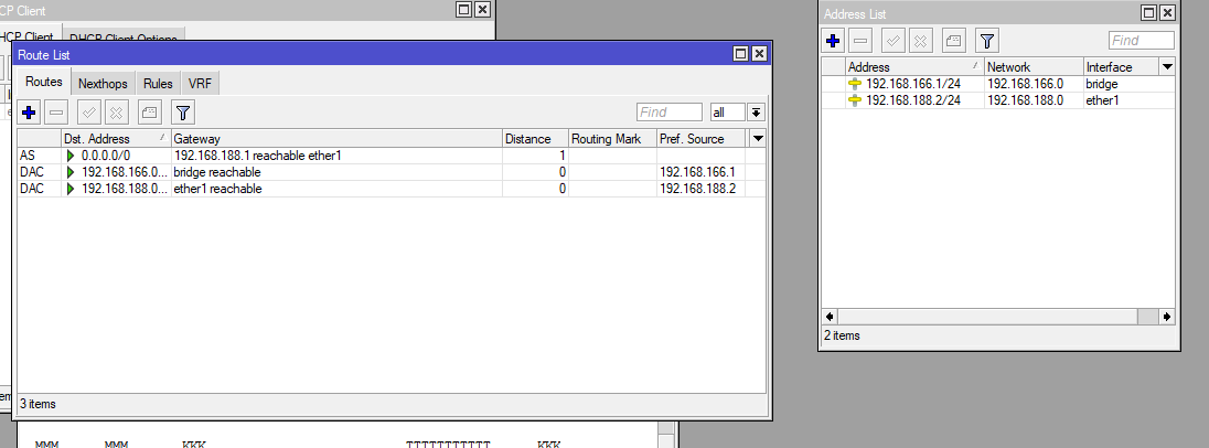

Some more details on my issue
  1. When i ping 192.168.188.2 from 192.168.166.X subnet i see a response
  2. Ping to 192.168.188.2 or any internet connection fail
  3. Route list in the image below shows 192.168.188.1 as reachable.
  4. When i check Fios router i dont see 192.168.188.2 assigned to MikroTik. This suggests Mikrotik router is not talking with FIOS router
Thanks in advance.
The fios didnt give out dhcp and thus it would not be visible, you statically assigned it from the MT side.
Suggest you enter the fios and also statically assign the iP to the router.
