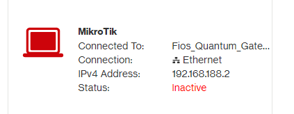

I already have setup MikroTik router setup as static on FIOS too. Here is the image that shows MikroTik Router is showing as inactive.
Not sure of fios settings is there something else on that thing that needs to be enabled?

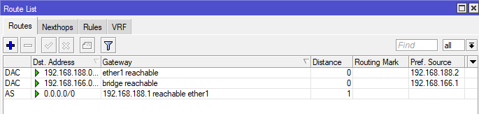

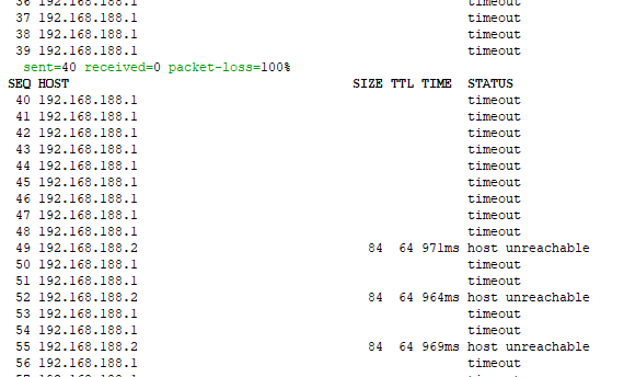

Changing cable did not help. There are other computers connected to FIOS with no issues. So FIOS DHCP is working fine. When i check the route list in MikroTik, it shows 192.168.188.1 as reachable through ether1. I expect to see unreachable if there was some cable issue(image below).When i ping FIOS router from PC on MikroTik router, i get timeouts but sometimes even the Mikrotik Router shows up as unreachable(image 2). Is there any logs i can check to see whats happening on ether1?
Image showing Route to FIOS is reachable
Image showing ping to FIOS is failing and sometimes Mikrotik router is showing as unreachable
Does the fios require a vlan to pass its internet? Highly unlikely but grasping at straws here.
Tools: Packet sniffer
https://help.mikrotik.com/docs/display/ROS/Packet+Sniffer
Tools: Torch
https://help.mikrotik.com/docs/display/ROS/Torch
https://wiki.mikrotik.com/wiki/Manual:Troubleshooting_tools
wireshark may be needed to read the traffic from packet sniffer in greater detail.
No VLAN needed. i updated my post above with images. See if it points to some issue.
