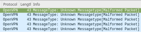

but not when sending the request from internal host part from the 192.168.1.0/24 network. When testing directly to IP where the service is working I got a successful response - both images were attached.

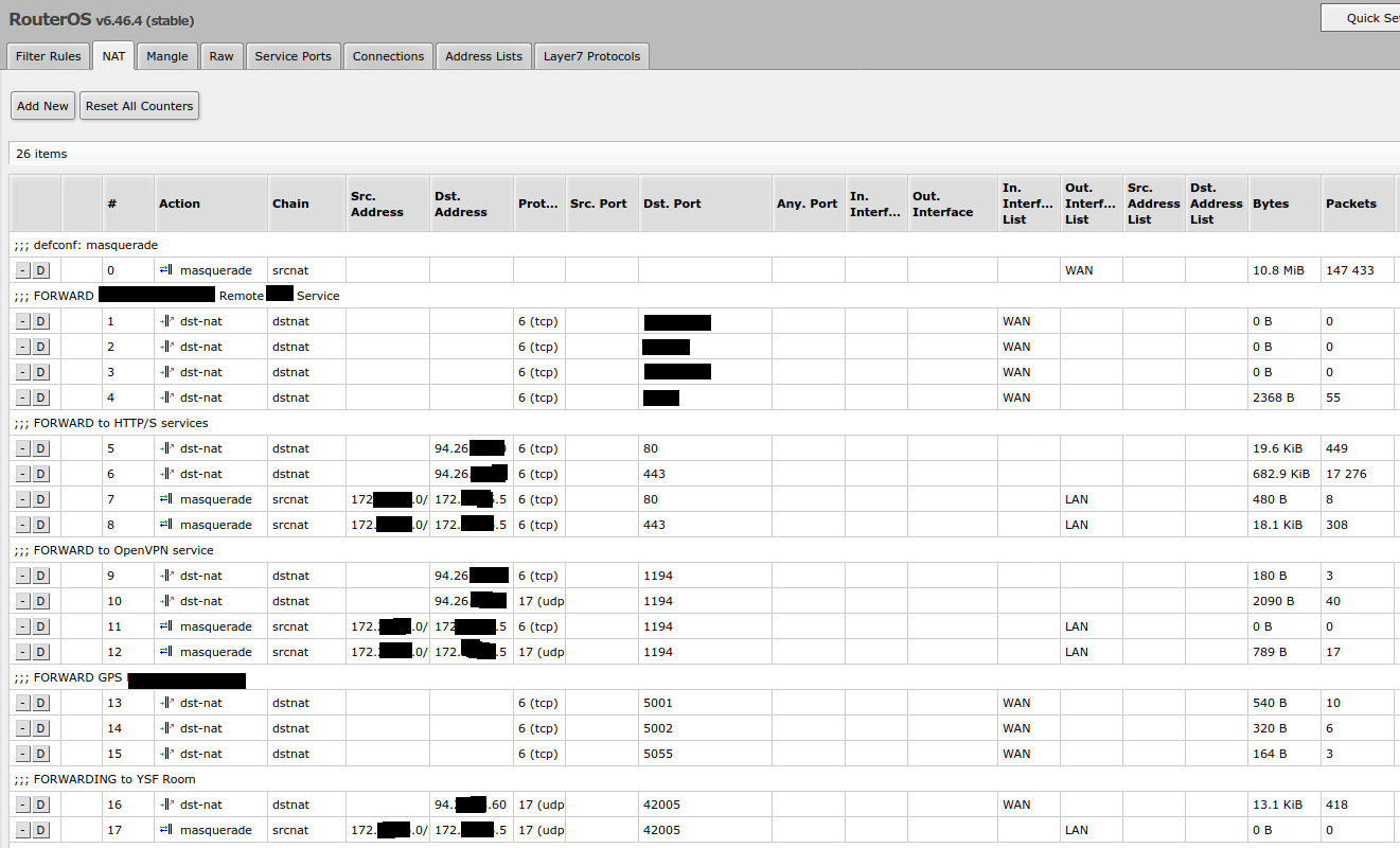

All other rules are the same as yours. Here is the example of how the VPN rules are implemented and the internal request to VPN port is accessible and the rules for another service port which is not working
add action=dst-nat chain=dstnat comment="FORWARD to OpenVPN service" dst-address=WANSTATICIP dst-port=1194 protocol=udp to-addresses=\
    192.168.1.10 to-ports=1194
add action=masquerade chain=srcnat dst-address=192.168.1.10 dst-port=1194 out-interface-list=LAN protocol=udp src-address=192.168.1.0/24
add action=dst-nat chain=dstnat comment="FORWARDING to YSF Room" dst-address=WANSTATICIP dst-port=42005 in-interface-list=WAN \
    protocol=udp to-addresses=192.168.1.10 to-ports=42005
add action=masquerade chain=srcnat dst-address=192.168.1.10 dst-port=42005 out-interface-list=LAN protocol=udp src-address=192.168.1.0/24
There is no problem when sent request to this port 42005 from the outside (Internet) the traffic passed through the nat rule responsible to deliver the traffic to an internal address correctly but not from the Intranet. The masquerade rule didn’t process any request from LAN via the WAN interface. The problem is that the software always sent a request to real Internet IP like a DNS A record but directly to IP than DNS name. That is because I cannot use internal DNS cache to redirect the request directly to internal IP.
I did the following test by the way. I reconfigured the OpenVPN to listen to 42005 and stop the service which is using this port. And the result is absolutely the same. When the VPN listen to 1194 the traffic from internal subnet via the WAN is passed. When OpenVPN is listening on 42005 nothing happens. Traffic/Packet statistics on the web didn’t count anything. That is because I think there is an issue with the firewall which didn’t work with high range of ports probably.

Hint: You’re connecting to public address from LAN. Do you think that rule with in-interface-list=WAN will pay attention to this connection?
Thats vague.
If the person had created a dst nat rule where the wan interface is dynamic then its perfectly legit to use in-interface-list=wan, however
If the person wants lan users on the same lan interface as the server, to reach the server via the WANIP, then thats a different case and would not use in-interface-list=wan.
Is there a difference if I use in-interface-list=WAN or in-interface=ether1 when in the list WAN exist only ether1. In my case, there is no probably any difference if I use directly static IP in Dst. Address or WAN List as in-interface-list or ethernet port ether1 at in-interface.
I don’t know. It can be the wrong approach.
For dstnat rules, with a fixed wanip, you should NOT use in-interface-list=wan, you should use dst-address.
For dstnat rules with a dynamic wanip, it is okay to use in-interface-list=WAN, except for the case where you want to hairpin nat that server.
For sourcenat rules…
One uses masquerade action for a dynamic wanip with out-interface-list=WAN
One uses src-nat action for fixed wanip with out-interface-list=WAN and to-address=thefixed IP
Thanks a lot, Anav
Based on your explanation I did changes in both dstnat and srcnat rules. Now looks everything works. It looks have to follow strictly the type of interface or address you are using in the rule.
Now the rule looks
 0    ;;; Masquerade Public WAN IP
      chain=srcnat action=masquerade out-interface=ether1-tbc log=no log-prefix="" ipsec-policy=out,none
16    ;;; FORWARDING to YSF Room
      chain=dstnat action=dst-nat to-addresses=192.168.1.10 to-ports=42005 protocol=udp dst-address=94.PUB.INT.ADD connection-mark="" dst-port=42005 log=no log-prefix=""
17    chain=srcnat action=masquerade protocol=udp src-address=192.168.1.0/24 dst-address=192.168.1.10 out-interface=bridge-lan dst-port=42005 log=no log-prefix=""
