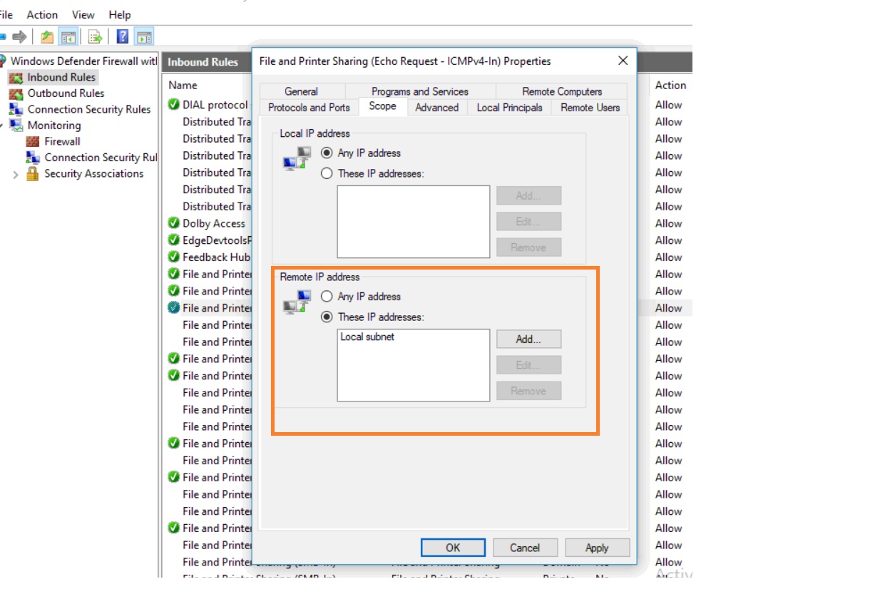

If it’s the built-in firewall rule for icmp echo request, it’s limited to local subnets, check its properties.
Hello Sob,
Yes, you are right.
Was able to locate the mentioned option so for other ones who will face this issue, mentioned option is located here:
Change it to “Any IP address” or define it regarding to needs.
