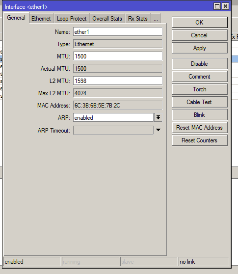

I am facing an issue on 3 separate RB951G2HND routers that the Ethernet connection to the router via the 5 ports is constantly switching between cable plugged, link ok, cable unplugged . This keeps on repeating. I can’t connect to the routerOS via winbox through Ethernet. If i connect to it via WiFi then i can access the routeros. This leads me to believe the issue is with the switch chip.
Additionally in Winbox when connected via WiFi there is no option to set the master port under the Interface tab of the Ethernet. See attached screenshot.

Which version of RouterOS? Since 6.41 there is no master port anymore. You must always use a bridge to group wired ports, then bridge (it also has “port” personality) functions as master port functioned previously.

Winbox Ver 3.18
Firmware 6.42.1
Routerboard updated to 6.42.10 - same behavior.
