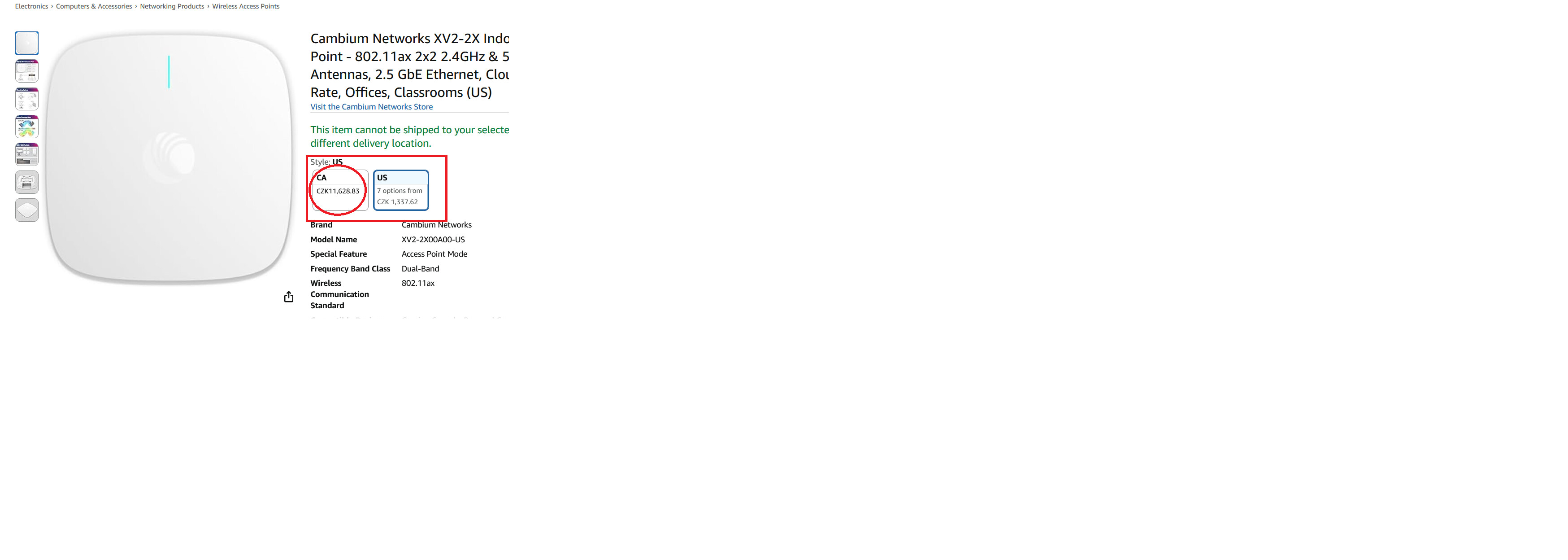

I pointed out early… The best price I can get for cap AX is $112.
If I buy enough of them… I can get a 2x2 AX indoor ceiling mounted antenna for $130.
I have seen Cambium XV2-2s sold online at reputable distributors for $100 each, during sales.
Ruckus R550s… I regularly see them on Amazon and the like for $350-$500.
That ain’t 10 times. And as I always say… “it doesn’t matter what it costs, when it doesn’t work!”

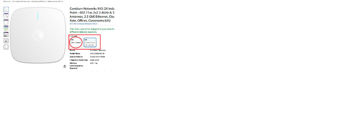

These cambiums retail for €400+ incl. vat. A cap ax is about €105+ currently.
Problem is, that I am not able to get material what you mentioned for the price what you mentioned …. :frowning:
This is reason why I ordered ubiquity and testing his stability.
See picture:
Ruckus is in Czech more expensive then Cambium.
Every official distributor here are on the same price. Picture above is from Amazon.
Mikrotik WiFi working, not on 100% but working … My price for AX is under 100$. AX seems to be working well. AC with the new driver and settings also seems to be working without any major problems. In our country, institutions really save money wherever they can, and I understand that it's difficult to understand. Maybe if I started billing them the full amount of my work, they would start thinking differently, but it would probably end up with them finding someone else to manage it for them, and somehow it would work... but you have to experience it to understand it...
