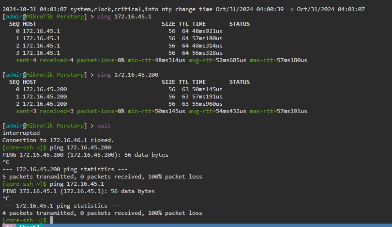

Today I use IPSEC but would like to switch to Wireguard. I have Wireguard up and running, but I cannot ping the remote client from the LAN.
[admin@MikroTik Office] > ping 172.16.46.200
SEQ HOST SIZE TTL TIME STATUS
0 172.16.46.200 56 63 57ms13us
1 172.16.46.200 56 63 47ms526us
2 172.16.46.200 56 63 50ms886us
3 172.16.46.200 56 63 53ms574us
sent=4 received=4 packet-loss=0% min-rtt=47ms526us avg-rtt=52ms249us max-rtt=57ms13us
C:\Users\sfrol>ping 172.16.46.200
Pinging 172.16.46.200 with 32 bytes of data:
Request timed out.
Request timed out.
Request timed out.
Request timed out.
Ping statistics for 172.16.46.200:
Packets: Sent = 4, Received = 0, Lost = 4 (100% loss),

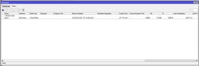

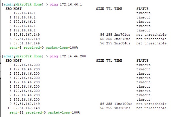

HI
I still have problems, still no connection between the two lans
office_new.txt (7.73 KB)
remoteoffice_new.txt (6.46 KB)
  1. Until you make up your mind on wireguard, no progress can be made.
    Which is router peer SERVER for handshake?
    Which is router peer CLIENT for handshake?
  2. You limit wireguard to one effective user (/30) WHY???.. it limits your ability as admin for both routers, to access both router while away from multiple device, laptop, smartphone, ipad… etc.. Or the admin just responsible for the remote router with same etc… at least look at 29 which yields like 6 hosts.
  3. Ensure detect internet settings is set to NONE as it is known to potentially cause issues.
I will assume the home router is the Main Router…
Main Router
/interface wireguard
add listen-port=15677 mtu=1420 name=WG-Home
/interface wireguard peers
add allowed-address=10.20.30**.2**/29,172.16.46.0/24 interface=WG-Home public-key=“KEY” comment=“remote router”

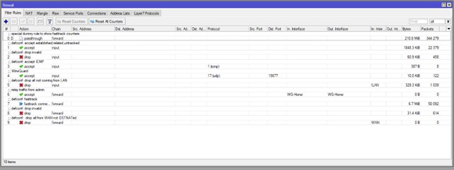

/ip firewall
{input}
add action=accept chain=input comment=WirwGuard dst-port=15677 protocol=udp
{forward)
add action=accept chain=forward comment=“relay traffic from admin” in-interface=WG-HOME out-interface=WG-HOME
note: this will allow you as admin to connect peer to peer to the home router, and then connect from there to the remote router for whatever needs!!
For the rest of firewall rules, dont see any major issue except for the mismatch of rules. Clean it up.
Keep input chain rules together and keep forward chain rules together and any errors or wrong ordered rules will be much clearer.
For example you have a bunch of forward chain rules that should be after the default rules of fastrack and accept establish related.
Last point: ensure you modify the interface list member
add interface=WG-HOME list=LAN

Sorry, but am I missing something?
I still don’t have a connection between the two lans.
Wierguard running but no ping between Home (Main Router) and Perstorp (Remote Router)
Please post the latest versions of each device.

  2. Firewall rules need work, for starters can you tell me WHY you have this rule…
    /ip firewall filter add action=accept chain=input dst-port=13231 protocol=udp ???
  3. Keep chains together much easier to read and spot problems. The relay rule is strictly for the Server Peer ( aka the other router → think of the logic all peers connect to the server for peer to peer connection. ON the server its where in fw rules we want to allow traffic to exit the tunnel and enter another tunnel outbound ( only the server peer as multiple tunnels )… and rules in the following order.
    /ip firewall filter add action=accept chain=input comment=“defconf: accept established,related,untracked” connection-state=established,related,untracke
    /ip firewall filter add action=drop chain=input comment=“defconf: drop invalid” connection-state=invalid
    /ip firewall filter add action=accept chain=input comment=“defconf: accept ICMP” protocol=icmp
    /ip firewall filter add action=drop chain=input comment=“defconf: drop all not coming from LAN” in-interface-list=!LAN
    /ip firewall filter add action=fasttrack-connection chain=forward comment=“defconf: fasttrack” connection-state=established,related hw-offload=yes
    /ip firewall filter add action=accept chain=forward comment=“defconf: accept established,related, untracked” connection-state=established,related,untracked
    /ip firewall filter add action=drop chain=forward comment=“defconf: drop invalid” connection-state=invalid
    /ip firewall filter add action=accept chain=forward comment=“internet traffic” in-interface-list=LAN out-interface-list=WAN

  1. On the Peer Server one identifes the peer client by single IP address at the allowed IPs settings!..so should be.
    /interface wireguard peers add allowed-address=10.20.30**.2/32**172.16.46.0/24 comment=“remote router” interface=WG-Home name=peer1 public-key=“KEY”

Hi I’m very confused, followed your recommendations with still no traffic from server 172.16.45.200 ↔ 172.16.46.200 none of the ways.
If I try ping from Home router to Perstorp 172.16.46.1 I get a response, but ping to 172.16.46.200 I get a timeout and “Drop all else” on
Perstorp blocks traffic. “forward: in:WG-Perstorp out:bridge, connection-state:new proto ICMP (type 8, code 0), 10.20.30.1->172.16.46.200, len 56”
The same the other way around
“forward: in:WG-Home out:bridge, connection-state:new proto ICMP (type 8, code 0), 10.20.30.2->172.16.45.200, len 56”
If I disable the “Drop all else” rule I get a response.

Firewall forward chain rules have to be moved in the order, and remove the old ones!!!
/ip firewall filter add action=accept chain=input comment=“defconf: accept established,related,untracked” connection-state=established,related,untracked
/ip firewall filter add action=accept chain=forward comment=“port forwarding” connection-nat-state=dstnat
/ip firewall filter add action=accept chain=forward comment=“Remote users to local LAN” dst-address=172.16.46.0/24 in-interface=WG-Perstorp src-address=172.16.45.0/24
/ip firewall filter add action=accept chain=forward comment=“Local users into wireguard” dst-address=172.16.45.0/24 out-interface=WG-Perstorp src-address=172.16.46.0/24
/ip firewall filter add action=drop chain=forward comment=“Drop all else” disabled=yes log=yes
remove this rule: → the client peer is never going to relay wireguard, ( a function at the server router only as it is the one capable of connecting client peers
/ip firewall filter add action=accept chain=forward comment=“relay traffic from admin” in-interface=WG-Perstorp out-interface=WG-Perstorp
remove old noise.
/ip firewall filter add action=drop chain=forward comment=“defconf: drop all from WAN not DSTNATed” connection-nat-state=!dstnat connection-state=new in-interface-list=WAN
HOME ROuter - again I dont see any issue here other than rearranging order of forward chain rules. see if that helps at all.
Other than that, since I despise capsman will blame it LOL.
/ip firewall filter add action=accept chain=input comment=WirwGuard dst-port=15677 protocol=udp
/ip firewall filter add action=accept chain=forward comment=“relay traffic from admin” in-interface=WG-Home out-interface=WG-Home
/ip firewall filter add action=accept chain=forward comment=“Remote users to local LAN” dst-address=172.16.45.0/24 in-interface=WG-Home src-address=172.16.46.0/24
/ip firewall filter add action=accept chain=forward comment=“Local users into wireguard” dst-address=172.16.46.0/24 out-interface=WG-Home src-address=172.16.45.0/24
/ip firewall filter add action=drop chain=forward comment=“Drop all else” log=yes
Remove old rule:
