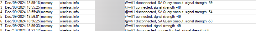

So all I can see in log is disconnected, SA Query timeout, signal strength -54.
The signal strength can change somewhat.
It’s always there in the logs but it becomes more and more frequent until the disconnections start.

I took another cap ax (this one is also tested before and also gives me disconnections) and configured it as my company caps. With this configuration it will be stable for a few days and then the disconnections start again.
If I reboot it when the disconnects starts, it's stable again for a few days.
Just like the other caps we're running and also my Chateau 5G ax that I have at home :frowning:.
Anyone with a suggestion on what I can change are welcome to comment freely :slight_smile:. What I already haven't tested I will test :slight_smile:.

I had problems with frequent disconnects when WPA3 was enabled. When I disabled WPA3 and PMF I never had an issue again with disconnects.
And my setup is RB5009 as CAPsMAN, 3 wAP ax as CAPs and one SSID (I’m using PPSK Mikrotik finally added to ROS) with 3 VLANs.
Frequencies are added manually for each radio to avoid interference.
I had cAP ax and IMHO wAP ax is working better for me but this could be placement issue. wAP ax is much more suited for my use case.
Disable WPA3 isn’t an option unfortunately but in testing it didn’t help us:(.
Unfortunately, WPA3 on Mikrotik is kinda broken… Like I said, i had same issues until I disabled PMKID i WPA3.
Looking at your config I see nothing wrong. Only thing you can do is send supout file to support.
Most of the time here on forum you will see that a lot of members suggest other users to use another AP. At work i installed U6 Lite from ubiquiti because we had the same problem (that was at the time Mikrotik had a lot of problems with wireless, i think that was around ROS 7.8 -7.9)
