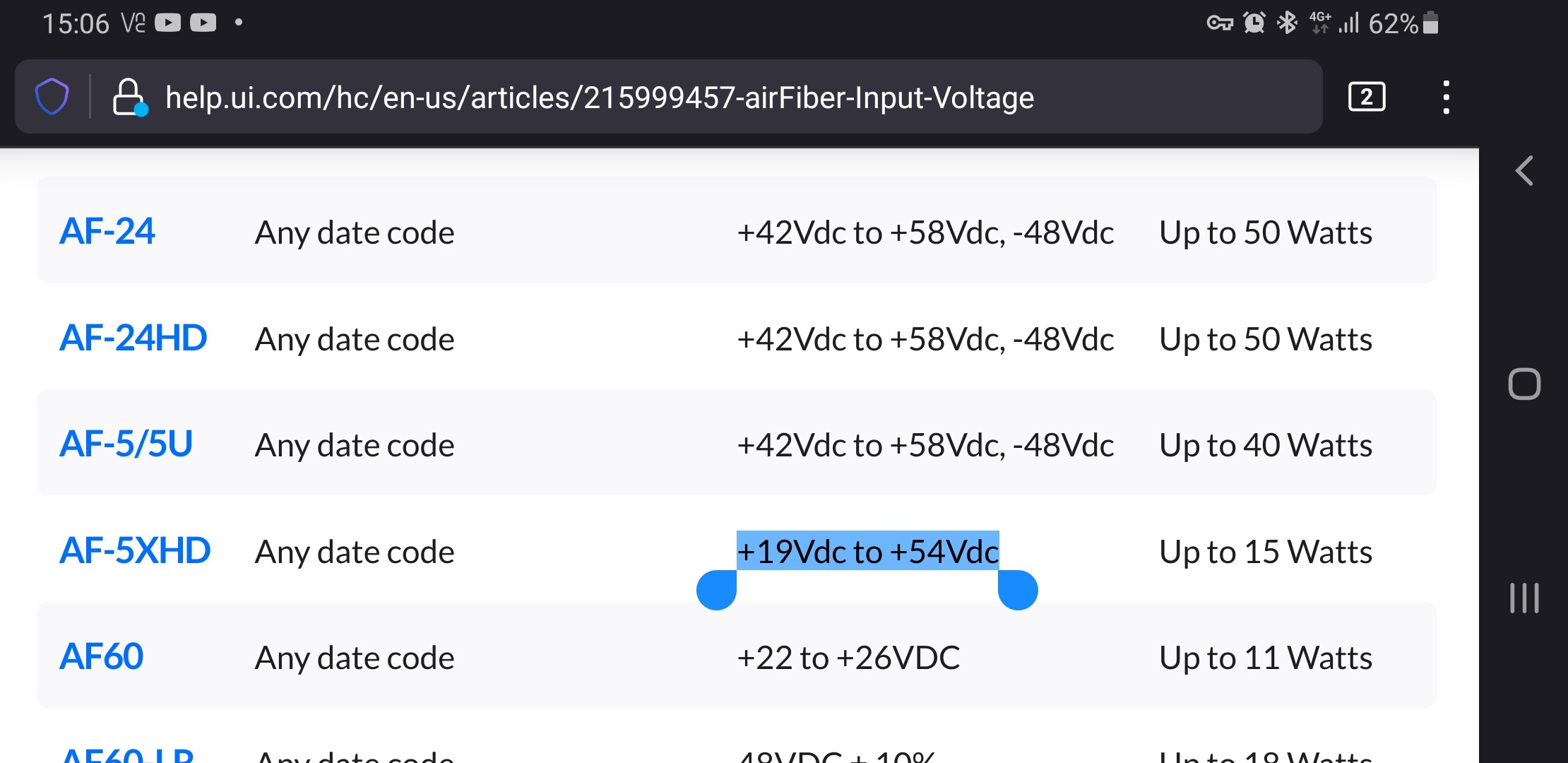

This image says something different.

And you resume this topic for say what?
“this image”?
I work with those devices, just installed two today (AF5XHD) and ALL are powered at 24~26V and I not need to see any picture

P.S.: this image says also, on the last line, (and I do not understand why) for AF60LR only 48V+/-10% (from 43,2 to 52,8)
I power two AF 60 LR with 24,8V and working. Are in production and last week the rain aren’t a problem (4.02Km link)
