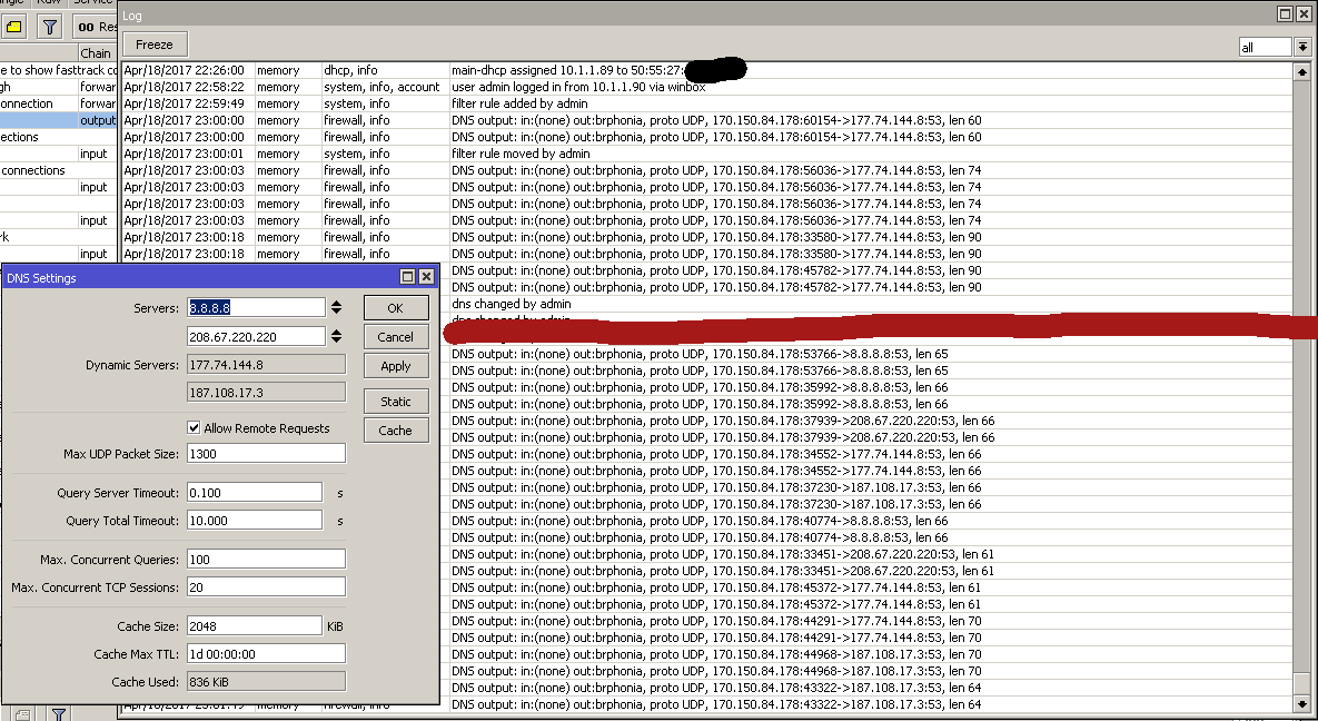

The gray are dynamic DNS obtained from dhcp/ppp connections. If you set some static DNS, they are queried first than the dynamic ones.

Edit:
I made a test to show to you how is the order of DNS queries using a firewall filter rule to log the packets. Of course the query timeout I reduced to low value to test easily.
You can view from the red line.
