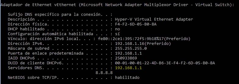

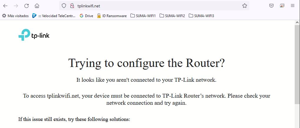

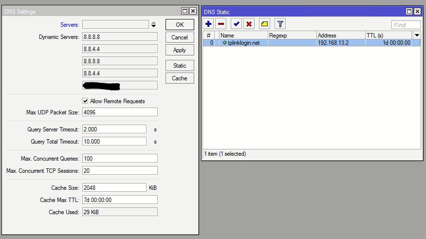

Hello, I already created the static dns. When you want to enter http://tplinkwifi.net/ through the browser, the screenshot that I attach appears. I also attach the DNS that the PC and the Microtik Thank you very much!
The IP on DNS must be 192.168.1.16, and the DNS must be what is wrotten under the tp-link router (tplinkwifi.net or tplinklogin.net? simply create both and try both)

@merced25, the basic idea of that TPlink thing is that if the DNS query for tplinkxyz.net is not intercepted by the TPlink device acting as a DNS server, it reaches the global DNS network and gets resolved to a public IP address of some server in TPlink cloud, which returns the page you have posted. So to beat this, you have to add a static DNS record for every tplinkxyz.net name the TPlink router pushes to you until you get them all. Optionally, you may be able to use a single static DNS row with regexp=tplink.*.net rather than many rows with exact names.
The printout from the PC shows that two DNS servers are configured, 192.168.1.1 and 8.8.8.8, so the query may get to 8.8.8.8 and be responded from the global DNS which is not what you want.
8.8.8.8!!!

I did all the configuration pointed out but I continue with the same screen of tp-link. Two comments, one, I was wrong in the first post, the IP of the PC is 192.168.1.16. I took this into account when making the proposed configuration. On the other hand I have 2 AP Tplink, one in the 192.168.1.X network that I can access and the other in the 192.168.13.X network (the latter is the one that I cannot manage via browser) both use http: / /tplinkwifi.net/ Thanks and sorry I'm a newbie to networks and microtik!

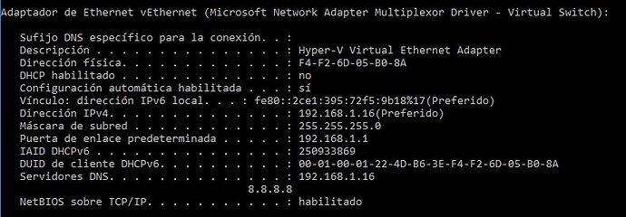

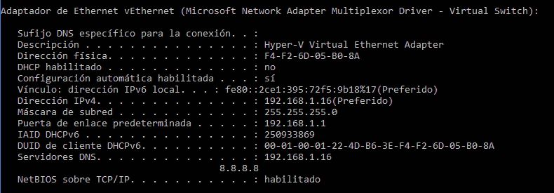

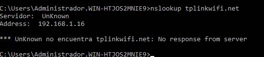

It’s not so much a Mikrotik issue, it is a TP-link one. Have you managed to get rid of 8.8.8.8 as a DNS in the PC configuration? What do you get if you run the commandline on the PC and enter nslookup tplinkwifi.net there?
As I am working remotely, I am afraid to delete 8.8.8.8 and lose my connection to the computer. The main DNS of the PC is 192.168.1.16 (the PC itself) I attach screens of what you ask me. Thanks!
