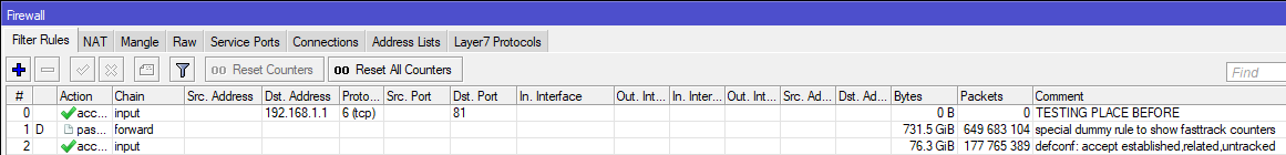

/ip/firewall/filter/add
=chain=input
=dst-address=192.168.1.1
=protocol=tcp
=dst-port=81
=comment=TESTING PLACE BEFORE
=place-before=*37
!done
=ret=*38
/quit
