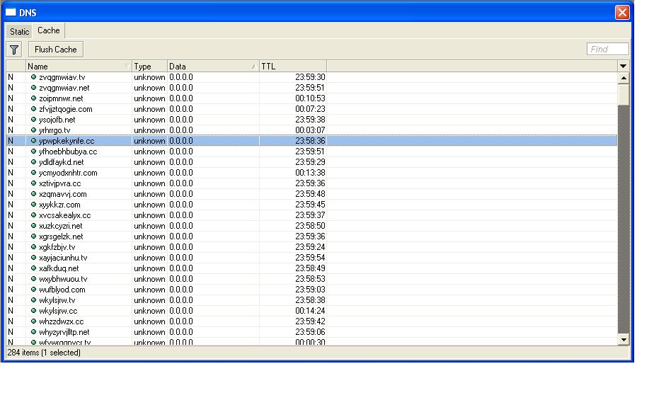

hi
after a secend of flush the DNS cache this what i had( In Pic) :
zvqgmwiav.net unknown 0.0.0.0
zvqgmwiav.cc unknown 0.0.0.0
zrafqswyb.cc unknown 0.0.0.0
and the list go on, when i stop the tracking in ip-firewall-connections
the site stop appearing.
the problem couse site browsing slow and the DNS cache get full in about 10 Min !
is it kind of worm or what?
if it is how to stop it ,
note :
the 0.0.0.0 address and the sites scr address dose not appears in connections list and torch .
