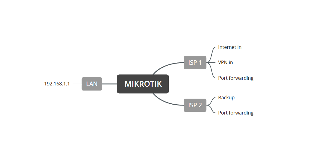

Hi guys, im gonna try to explain me.
I need config a router with 2 ISP, VPN pptp (or similar but no sstp (i need this port 443 for guacamole)) and port forwarding for VM connection. I tried a lot of config i find here but its impossible for me.
I want to believe that I am doing something wrong because although it is not easy, I don’t believe it has never been done.I attached a simple plan of what I want to do.
With this config:https://wiki.mikrotik.com/wiki/Manual:PCC#NAT only work port forwarding the first ISP.
With this http://forum.mikrotik.com/t/recursive-routing-not-wokring/161769/1 not work.
If someone can help me with another post or something i appreciate, tomorrow can update this post with my last config (in this the 2 wan work, port forwarding work but the VPN not connect )

Sorry for the delay, i cant go to the office this week.
# jul/04/2024 20:47:11 by RouterOS 6.49.10

This configuration is from a client but it is basically the same as what I have in the office
i tried to explain me. With this config can use port forwarding in the 2WAN (can redirect ports to ip) at the same time and obviously can access to internet but if i tried to config a VPN (l2tp or pptp for example not work) Im not using the ports vpn use.
What I need is to forward ports from both WAN and access from one of the two WAN with VPN, I don’t care which of the two the VPN access
sorry if something is not understood, I’m still learning English
