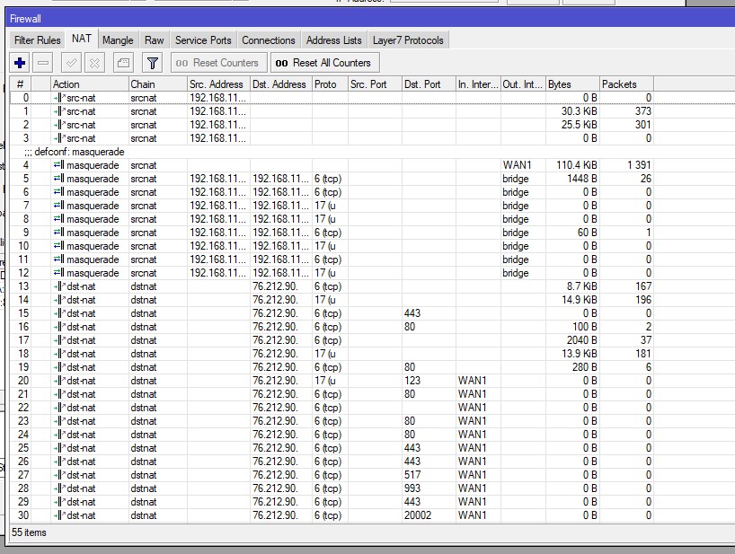

I have two externally accessible servers, each with primary and secondary LAN connections. I had hairpin NAT rules set up to allow all of the other computers and devices on the network to talk with/to them, and the rules were working. Earlier this morning, I upgraded my RouterOS packages to 6.42.3. Now I can’t reach the secondary server, on either network connection, from anywhere on my LAN although it still responds fine to requests from WAN. I suspect I need to make changes in my firewall rules, but I don’t know exactly what change to make. Screenshot attached.
Open two more colon “To Address”, “To Ports” and find to which local IP:port you translating your 76.212.90.etc
It’s going to the proper IP addresses and ports. As I said, it was working and I haven’t changed that. And I can reach the second server from a browser on the LAN using the local IP address, and services from outside can access through the WAN without issue. It’s only when I try to access using the domain name (and DNS) from within the LAN that I have a problem. And, again, it appears that the problem started after I upgraded to 6.42.3.
Edit To Add: I’m posting the picture, but I’m posting it from my own server so that I can take it down once the issue is resolved:
