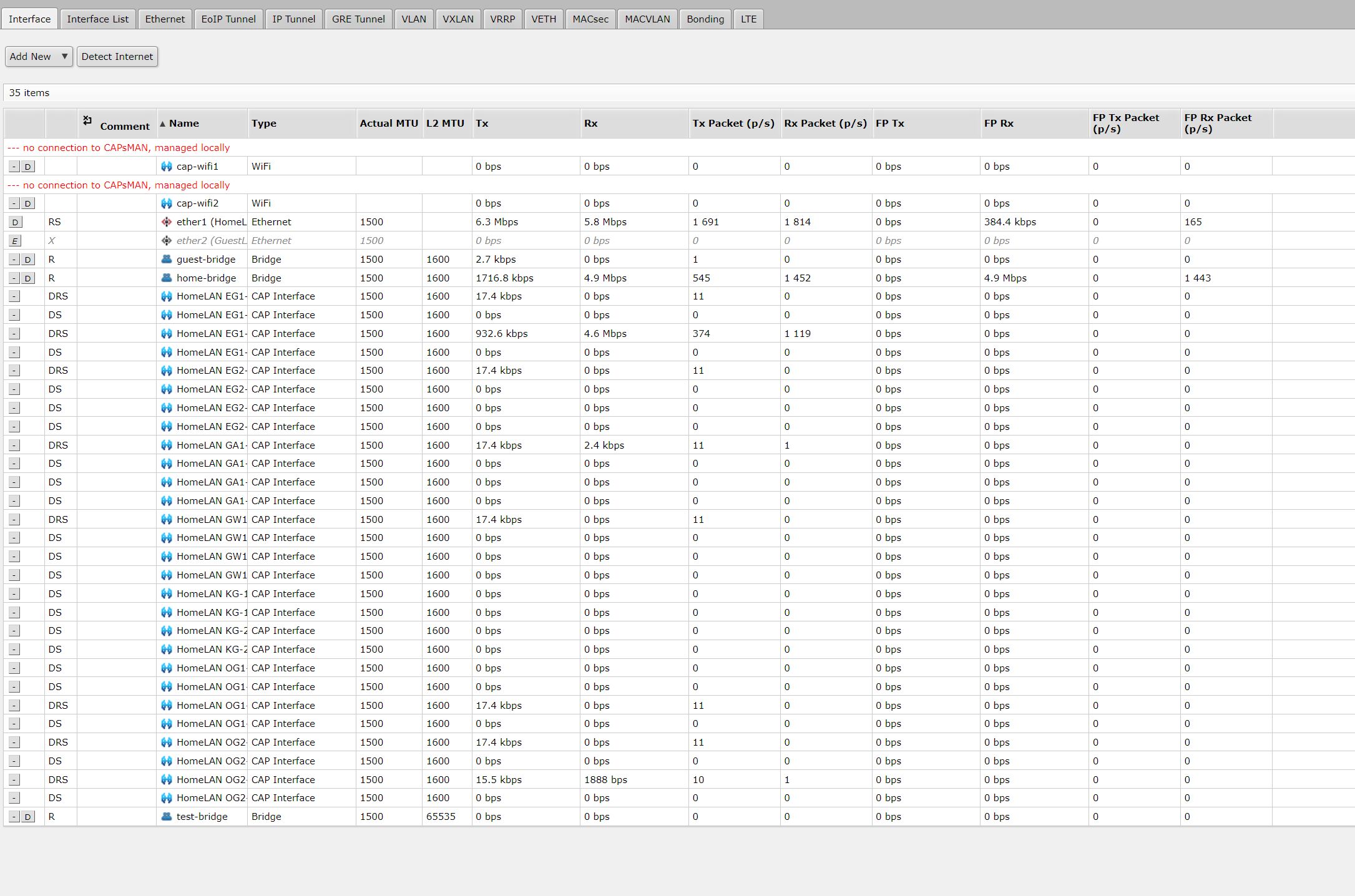

If setup the CAP ax xl as a remote AP i get on the WIFI Tab two devices (cap-wifi1, cap-wifi2) is that correct?
After doing the configuration setup i will see both interfaces with the message “no connection to CAPsMAN, managed locally”, is this correct?
Everything is working and i can connect to the WLAN Service
My config looks like this, do you see any mistakes or missing information?

About the difference:
cAP AX is purely wave2 radio.
Cap XL AC is “old” wifi but since 7.13 it can also use wave2 drivers (same for cap AC but also wAP AC, if it is the ARM version).
So …
When your cAP is in capsman mode, it will show in Interfaces as “managed by capsman”.
From terminal, export config
export file=anynameyouwish
Move file to PC, edit for any remaining sensitive info and post back here between [__code] quotes for easier readability.
Do this for both cAP AX and CHR acting as capsman controller.
Thanks, i really appreciate your help, here are the files
Your CHR has legacy ánd wave2 capsman config. That’s possible.
But why does it have local wifi interfaces configured ? Is there a wifi card on that machine ?

Your CHR is used as capsman controller and nothing else, correct ?
Then it should not have local wifi interfaces.
The CHR is only used to manage the CAP ac and the new CAP ax.
The cap-wifi1 and cap-wifi2 interfaces came up after booting the CAP ax. I thought, this is the new way how things will appear with the new software?
Local interfaces should not be there on CHR.
Does everything work for the rest ?
On the old CAPsMAN AP (CAP ac) i will see the Interfaces as “CAP Interface”, with the new CAP ax i see them as “WiFi”, but i tried to make the setup as i understood from the WIKI.
Where is my mistake, how should it be? Do you have some hints and tips for me?

Those local interfaces on CHR: maybe some leftover from conversion script towards 7.13.
Make a binary backup to be sure, then delete those 2 interfaces. They are not needed there.

The counters does not see any movements, always on “0”
I’am not sure about the “CAP” setups on “WIFI” Tabon my CHR Router, should there any setup or just disabled?
And i am confused about the “no connection to CAPSMAN” of the Interfaces?

Just checked on my CAPsMAN, don’t see any counter on both /interface and /interface/wifi.
Running 7.13.2 together with wifi-qcom-ac driver and cAP XL ac and wAP ac.
For one reason or the other I did not see notification on that post from Thu Jan 11, 2024 8:09 pm :confused:
Same observation here as erlinden.
No counters on capsman.
On local device they are being shown.
However, this does make sense with wave2 capsman and the absence of capsman forwarding. Traffic is not passing through capsman. So no counters.
