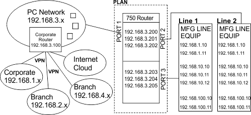

Hi Tws101,
I suppose some more background would have exposed – it’s already ‘complicated’. :neutral_face:
Some PCs in our 192.168.3.x network need access to manufacturing equipment in two lines. The manufacturer of the lines has preprogrammed PLCs with hard coded IP addresses, so renumbering the equipment not only would be a nightmare, but we’d loose all support from the line manufacturer and be on our own. So there are duplicates already, so you can’t just tie the networks together.
Also, corporate has control of the main routers used for internet access and VPNs to other branches. Which workstation on 192.168.3.x can see now. The corporate office IP scheme already overlaps the manufacturing equipment scheme. (192.168.1.x)
I’ve seen where you could route to specific ports on the 750 so I believe it should also have the ability to isolate the two line networks from seeing each other. My next logical jump was to create some sudo addresses and NAT rules to route to specific ports on the 750.
See now where my fun begins! :wink:
Looking at my attached network drawing; I want to map the following:
192.168.3.200 (sudo address) —> NAT —> Port 2 —> 192.168.1.10
192.168.3.201 (sudo address) —> NAT —> Port 2 —> 192.168.10.10
192.168.3.202 (sudo address) —> NAT —> Port 2 —> 192.168.100.10
192.168.3.203 (sudo address) —> NAT —> Port 3 —> 192.168.1.10
192.168.3.204 (sudo address) —> NAT —> Port 3 —> 192.168.10.10
192.168.3.205 (sudo address) —> NAT —> Port 3 —> 192.168.100.10
Port 1 would attach to our existing 192.168.3.x network.
There would be no need for routing outside the 192.168.3.x network to the mfg. line equip. (ie: no other gateway, just the sudo addresses translated)
Because of the duplicates I don’t see a way to do it with one router. I think you would need 3 routers.
Your pseudo addresses would be the WAN on the other routers. Just assign multiple address to them and setup NAT.
If anyone else knows how to do that with one router and handle the duplicate please post the solution.
