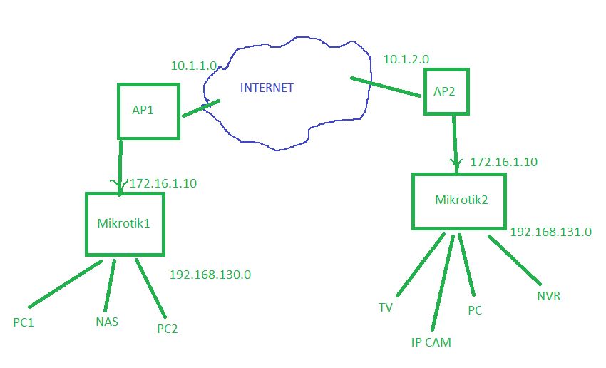

I have two houses where I have FTTH (the same provider). Behind the AP I have Mikrotik RouterBoard RB750Gr3 hEX. On both houses I have also public static IP and all incomming connections is forwarded to Mikrotik.
How can I securely join those two LANs?

for better explanation here is the image (IP address are fictional :slight_smile: )
I am beginner and would like to know, where to start

Setup is unclear
what do you mean “all incomming connections is forwarded to Mikrotik” ???
Do you have public IPs on the mikrotiks themselves, if yes setup is easy

Thank you! I will try this solution, it seems to be clear. My mikrotiks has no public IPs but from AP’s is forwarded alll communications to them, so it is quite the same.
