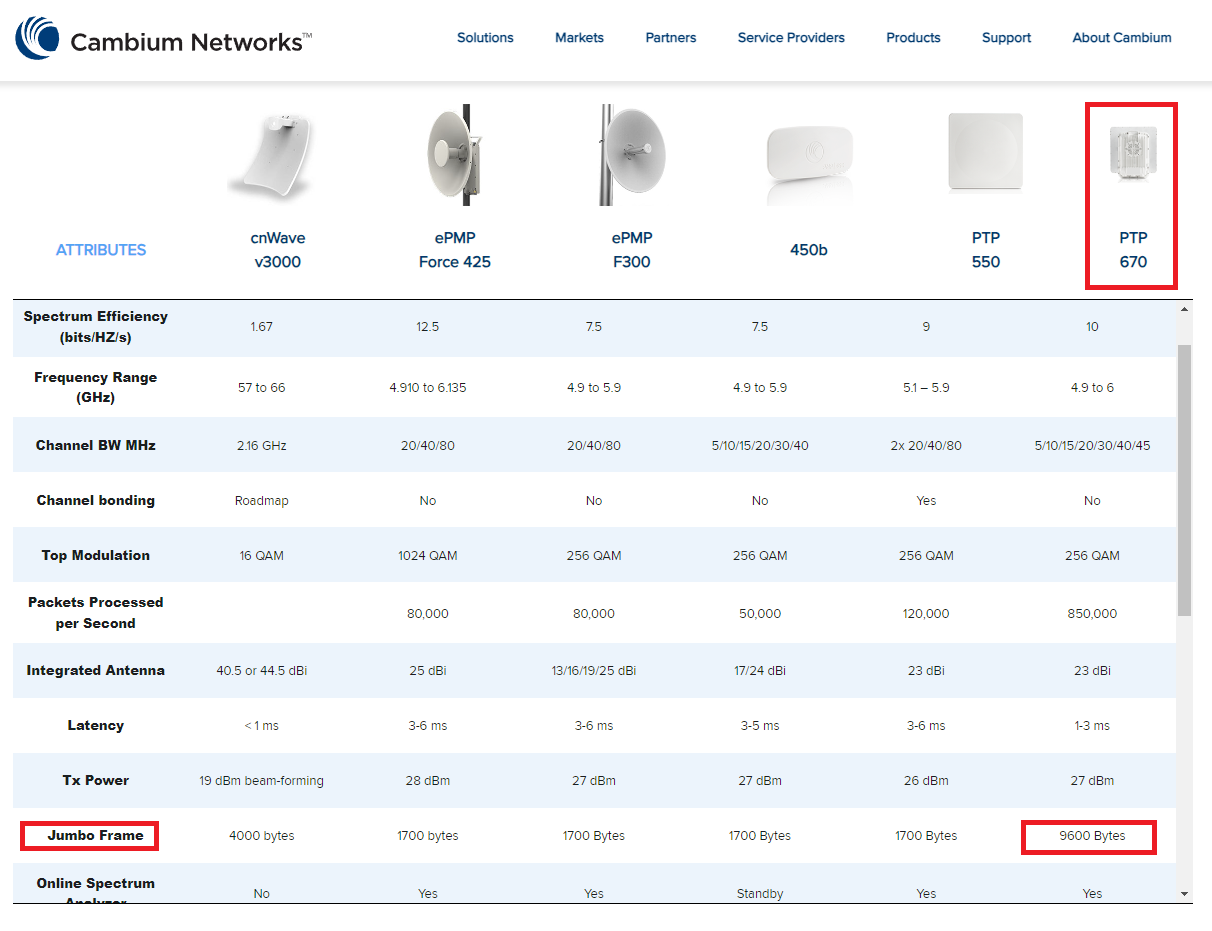

Think I found something I will explore further :
That’s right it’s not an 802.11 wifi device, it’s a wireless Ethernet bridges, it’s specifically designed for L2 traffic.
