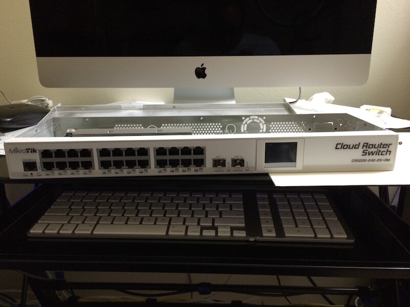

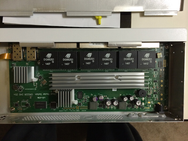

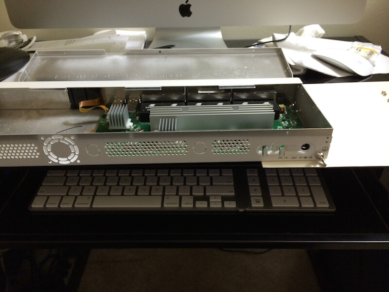

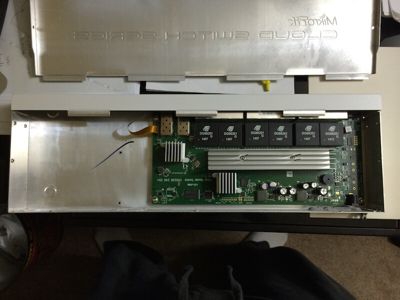

Just got my CRS226-24G-2s+RM!
Still working on initial config, but here are some pics!
No fans even, very nice! :smiley:

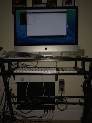

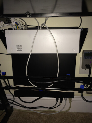

Also got the thing mounted to a 3U vertical wall bracket under my desk. I’ll put a pic up later tonight.
Ok, here’s an update…

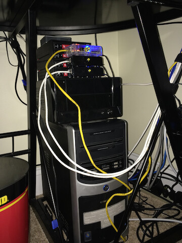

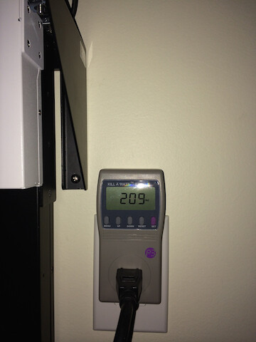

I’ve now confirmed with a Kill-a-watt that my CRS226 uses between 7-10W with CPU under 5% (my current idle load). I’ve also upgraded my office set up…
Behind the CRS226 is a CyberPower 1.5 KVA UPS (1U rackmount).
Connected to it is an emachines T5086 (used a 8TB FreeNAS), 3x Raspberry Pi (domain controller, mail server, VoIP server), another shoebox-sized server (don’t remember the brand) as a backup domain controller, and an analog phone adapter (all the way at the very top…not easily visible in picture)
Also hooked up to this is my new iMac
You’d think my electric bill with all this would be pretty bad…but according to the Kill-a-watt, my normal working usage is only…
209 Watts!
PS…I know the wiring looks like crap. I’ll get around to fixing it one of these days…
