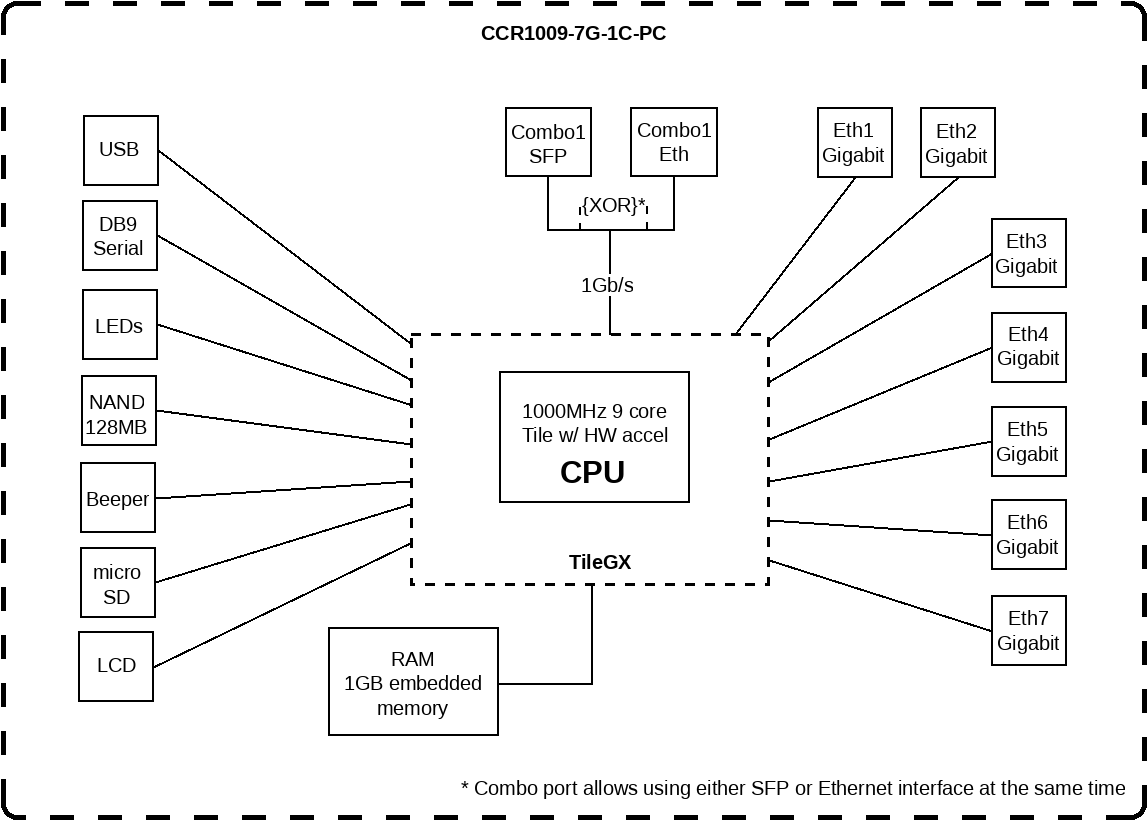

Important changes:
No switch-chip - the device now features only fully independent Ethernet ports each with a direct connection to the CPU, allowing to overcome previous shared 1Gbit limitation from switch-chip ports and utilize full potential of CPU processing power on those ports.
https://routerboard.com/CCR1009-7G-1C-PC

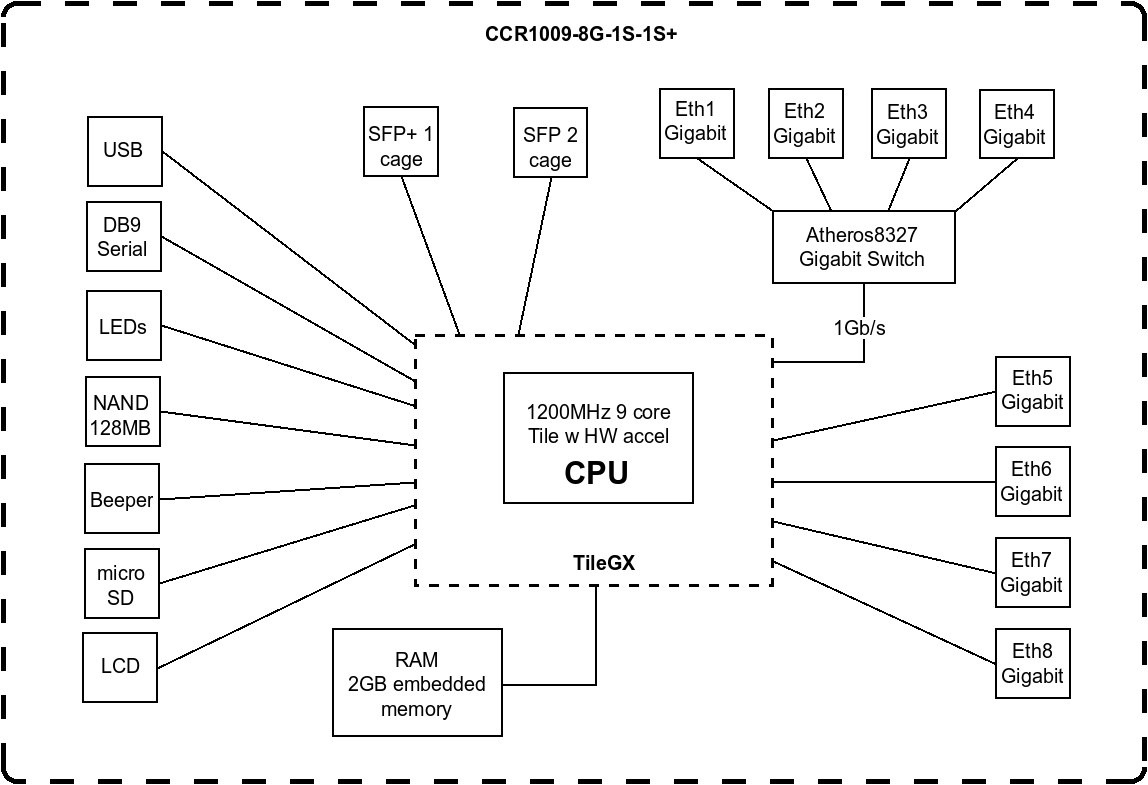

Compare previous CCR1009:
Note ether1-4 belong to a switch chip whose CPU lane is 1Gb/s; 4 gigabit ports share a 1Gb/s connection toward the CPU.
On it, briding ether1-4 would be a bottleneck due to the former; their optimal application was to build a “mini switch” by enslaving ether2-4 to ether1, and connect hosts that would be talking not only to the router, but directly between theirselves without traversing the CPU.
Compare vs Actual CCR1009:
All ether ports are now directly connected to the CPU with their own 1Gb/s lanes, so no bottlenecks, and more flexibility.
The limitation has never been the power of the CPU to run bridges, but the 1Gb/s shared lane for ether1-4.
Either router have more than enough power to run bridges in terms of CPU, this is only a concern on lower powered routerboards.
