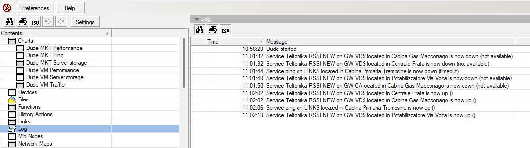

Is there a way to mantain dude log even if I restart the dude service?
Every time I restar the dude service (every night there’s a db backup), all the logs in “Log” section are gone.
Thanks in advance, Simone.

Could you try an option from the documentation - Manual:The Dude v6/Logs?
# Add new loging action specifically for The Dude
/system logging action add disk-file-name=dude-logs-main name=dudeLogsMain target=disk
# Add logging rule for dude topic with action that was just created
/system logging add action=dudeLogsMain topics=dude
Did a ROS restart and logs still in The Dude.
