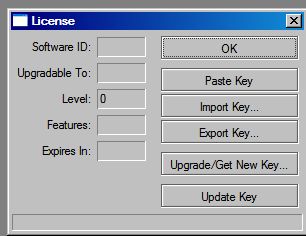

We’re running routeros 2.9.49 and login via winbox. We’ve had 4-5 weather related power bumps and outages. The last two were extended in length 3-5 days. We had backup power but it ran out. When power is back on we can login via winbox only to find our license level is “0” and the 24 hour countdown timer is on. During these times when I go into “System” and then “License” and sometimes there is nothing in the boxes for Software ID, upgradeable to, it says Leval 0, 0 features and the box is blank for expires in. Sometimes the 24 hour countdown is on. We went through this yesterday. Was able to copy and paste key from our file in mikrotick.com website and rebooted it. A few minutes later it showed everything required in the boxes. I just checked it a half hour ago and it is back to reading License Level “0” and the rest of the boxes are blank. I have to send someone to the site where the routeros is to cold boot it. This is getting annoying. Is RB-333 any better? What must we do?
reinstall it with netinstall and see what you see then. also try a newer version maybe
Last I saw a problem like this it was on my x86 ROS box with a bad disk.

I have faced a keylose problem once with an MT OS X86 box and couldn’t fix this problem then I had to changed the HDD(1st one had bad sector), our MT support was very kind n replace the key with the new one.
