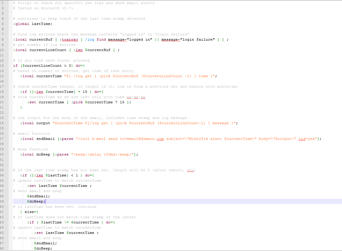

# Script to check for specific new logs and send email alerts
# Tested on RouterOS v5.7+
# container to keep track of the last time stamp detected
:global lastTime;
# find log entries where the message contains "logged in" or "login failure"
:local currentBuf [ :toarray [ /log find message~"logged in" || message~"login failure" ] ] ;
# get number of log entries
:local currentLineCount [ :len $currentBuf ] ;
# if any logs were found, proceed
if ($currentLineCount > 0) do={
# based on number of entries, get time of last entry
:local currentTime "$[ /log get [ :pick $currentBuf ($currentLineCount -1) ] time ]";
# check currentTime length, if length is 15, log is from a previous day and begins with month/day
:if ([:len $currentTime] = 15 ) do={
# trim currentTime so we are left only with time xx:xx:xx
:set currentTime [ :pick $currentTime 7 15 ];
# the output for the body of the email, includes time stamp and log message
:local output "$currentTime $[/log get [ :pick $currentBuf ($currentLineCount-1) ] message ]";
# email function
:local sndEmail [:parse "/tool e-mail send to=email@domain.com subject=\"MikroTik alert $currentTime\" body=\"$output\" tls=yes"];
# beep function
:local doBeep [:parse ":beep;:delay 150ms;:beep;"];
# if the last time stamp has not been set, length will be 0 (after reboot, etc)
:if ([:len $lastTime] < 1 ) do={
# update lastTime to match currentTime
:set lastTime $currentTime ;
# send email and beep
$sndEmail;
$doBeep;
# if lastTime has been set, continue
} else={
# if lastTime does not match time stamp of the latest
:if ( $lastTime != $currentTime ) do={
$sndEmail;
$doBeep;
Do you need the email functionality? If you only want to run a script when keywords are found, the email function can be replaced with whatever script you want to run. If you want the email to work, make sure you have configured “/tool e-mail” settings…

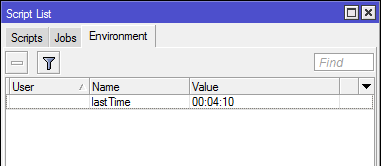

Check the System > Scripts > Environment tab. Does the lastTime variable show up? If so, remove it, and run the script again. Each time to run the script, if it finds a matching log with a different time stamp, this variable will change. If there are no “new” matching logs, then this will stay the same and no emails will be sent, so by removing it, it resets the process. For testing, you’ll need to 1) remove this before each time you run the script or 2) generate a new matching log entry.

- Check the System > Scripts > Environment tab. Does the lastTime variable show up? If so, remove it, and run the script again. Each time to run the script, if it finds a matching log with a different time stamp, this variable will change. If there are no “new” matching logs, then this will stay the same and no emails will be sent, so by removing it, it resets the process. For testing, you’ll need to 1) remove this before each time you run the script or 2) generate a new matching log entry.
Am I correct that if I have a reboot action on this script it not go into reboot loop if there is no new keywords are detected since time stamp of script > Environment tab

The global variable is stored in memory, so a reboot will clear it. So, I think it will go into a reboot loop.
This could be fixed by saving the time stamp in the comment of some permanent item (a user account comment, interface comment, wherever). Then the time stamp would survive a reboot. Example below, edited on line 1 and line 16.
